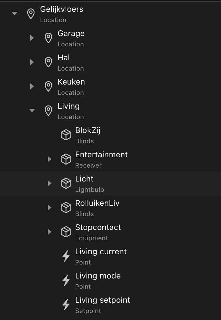

In every group i have 3 temperature values wich are different channels in my velbus system.
I have temperature, the current temperature that the system mesures.
I have the setpoint, the temperature i want in this room.
I have mode, these are 4 predefined temperatures (standby, night, day, comfort)
Before the changes i had to set the mode to change my temperature but let’s say if the mode was 20 degrees celcius, i had to change it tot 21 on the panels but could not change this in ophenhab.
Now i can change the wanted temperature to 21 using openhab but the mesured temperature is now shown as the wanted temperatured and stays flat.
I’ve added a screenshot of the model and opened the Living part but in all rooms you have the values.
The only difference is that in the Living i have grouped the items because there are to much items to be shown.
The 3 values i mention are all named Living.
I also changed the names because i thought this could be the reasing why everything goes wrong but this doens’t seem to solve my issue.

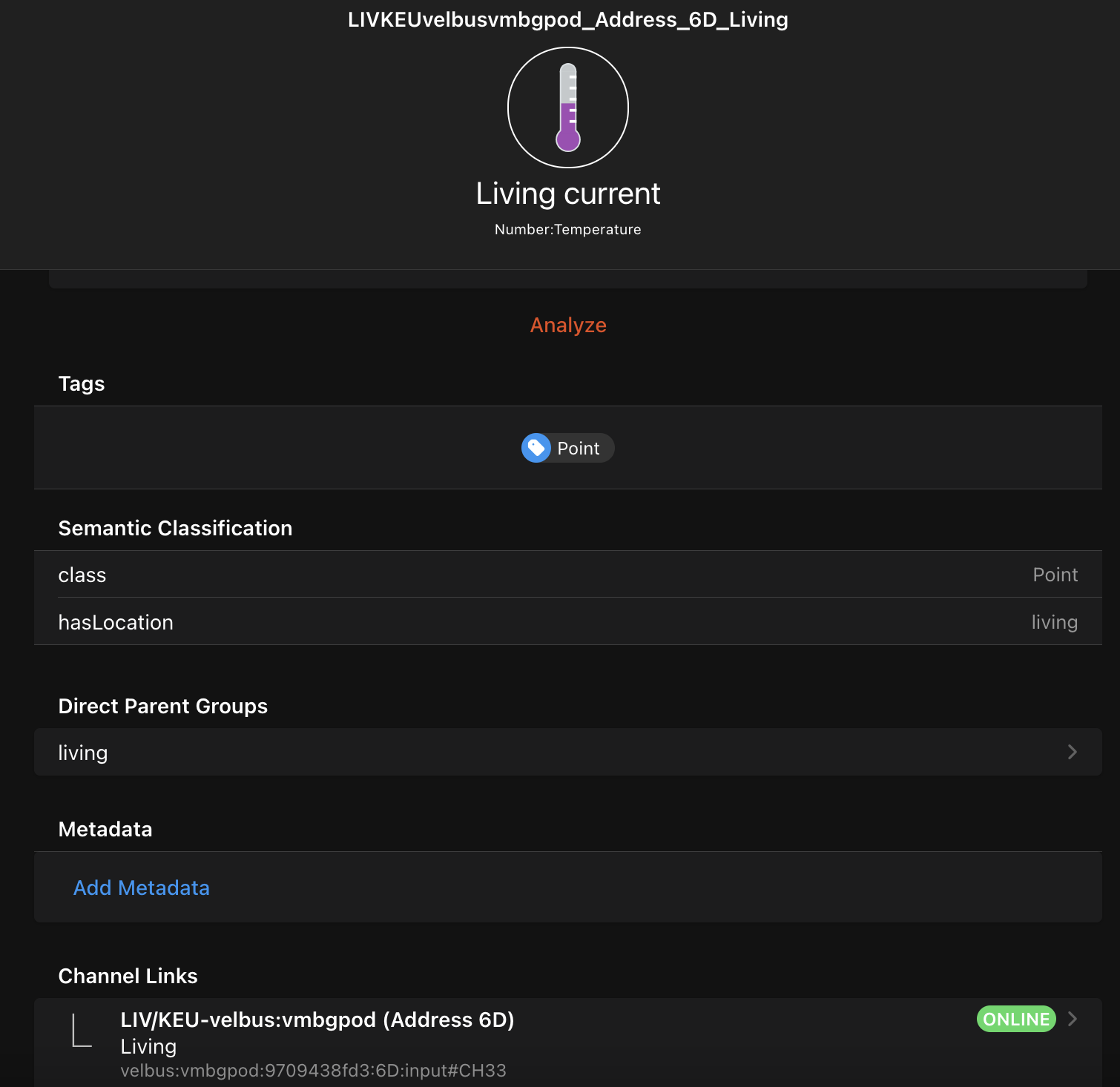

I’ve also added some prt scrn of the item Living current where i have the issue’s with.
I suspect that the problem is that you do no have these temperature inside their own equipment group.
In general the model expects (and looks for) all points inside groups to function properly. And in the model no point can be a member of more than one semantic group. There are a few very special exceptions to this rule. You can have a temperature item within a group and also have that item as a direct member of the location of that equipment group. When this is the case, that one temperature point is treated as the ambient temperature of the location.
It makes sense to have this arrangement for exactly this kind of case. When there are multiple temperature points inside the different equipment in one location the model cannot know without additional information which one of those points is the actual ambient temperature of the space.
Reconfiguring your model will probably fix this issue and is all but guaranteed to fix your issue on the other thread. All of those temperature points need to be in an equipment group (it can be the same one or not, that’s up to you), and only the one that is the actual, measured temperature can also remain as a child of the Living location.

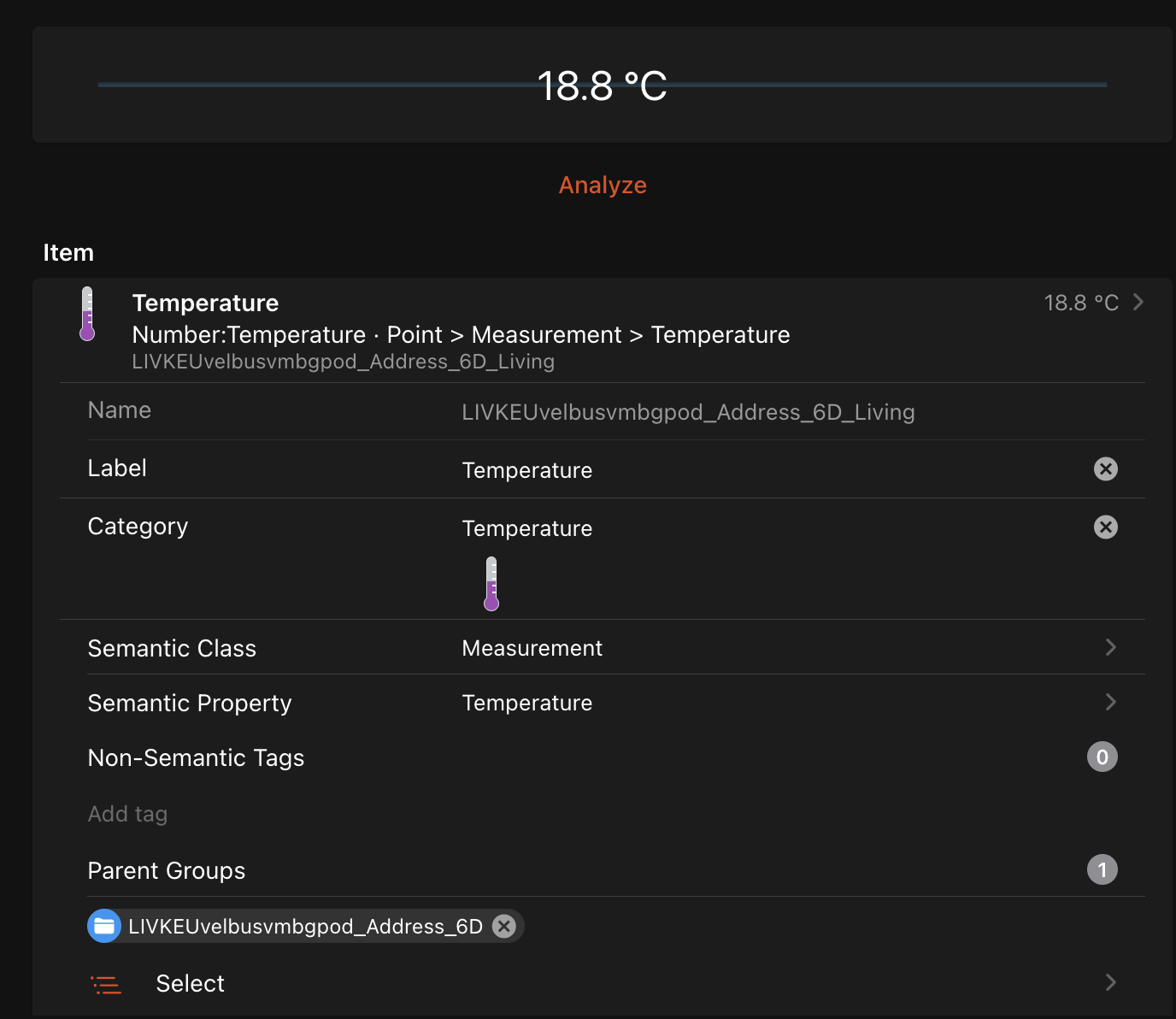

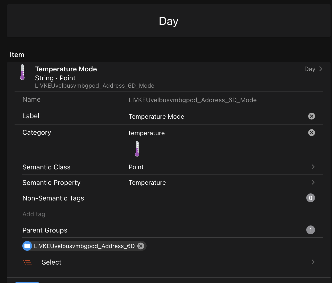

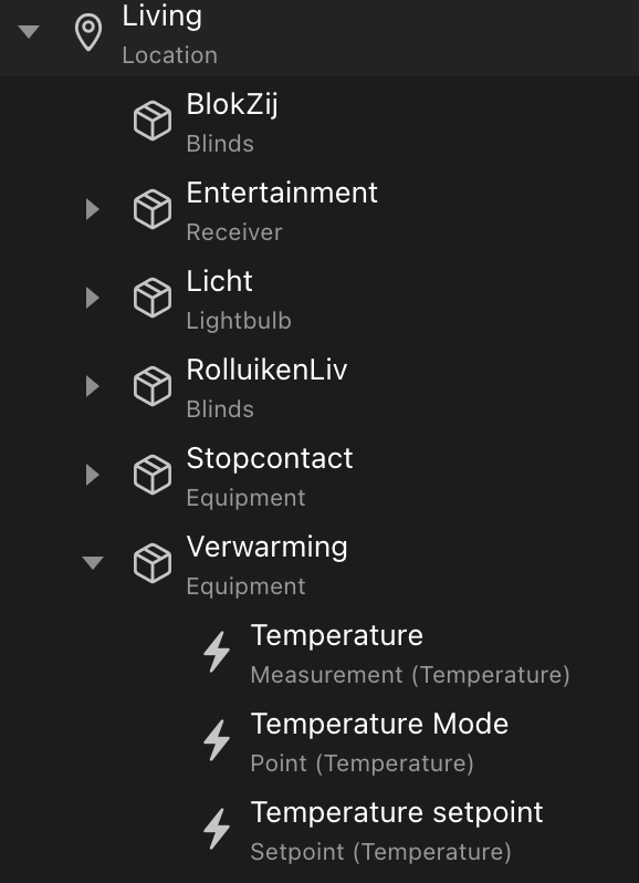

Created new equipment from the thing called “verwarming”.
With that i’ve added the 3 channels that i want to control because it comes from the same device.
I’m able to control the setpoint and i see the changes on the physical controlpanel.
I’m also able to control the mode and see the changes on the control panel.
What i’ve noticed is that when i change the mode from day to comfort is that i see the setpoint changing on the physical controlpanel but not on the ui in openhab.
As an example comfort = 21 and day = 17.
When chaning the mode to day i can see 21 on the physical panel but not an the ui.
Changing on the ui with the setpoint from 17 to 20 does work but when chaning the mode the ui does not get updated.
After all the changes i have this issue and the issues with the current temperature persists, the data does not get updated on the openhab ui.
I’ve added some picture of the current settings of the points and the model.

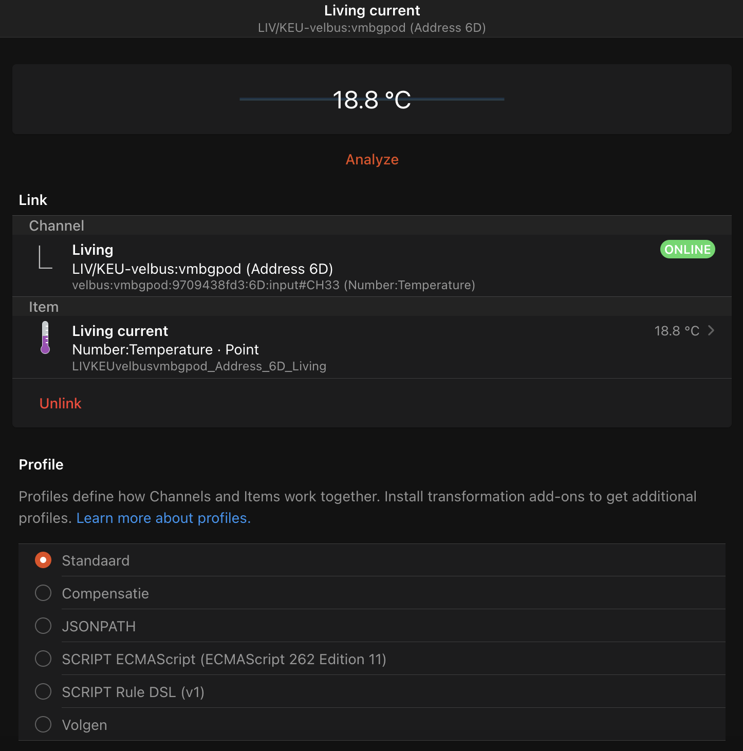

This is an issue with the binding, not the UI. I don’t know anything about velbus specifically, but it sounds like your items are not getting the updated information from the actual device.
When you change an item in OH, the system knows about that change and tracks it and also passes the requested change to the binding to be sent off to the real world, but what happens in the real world it has no knowledge of unless something reports bac. An item such as your mode item has no connection to the associated temperature item except through the binding. When you change the mode item OH knows that item has a new value but the temperature item will not get a new value until your velbus system correctly reports that a temperature setting has changed.
I suggest you look more carefully at the system configuration and the binding configuration. Maybe @MDAR has some velbus setup tips for you.
That all sounds correct. Did you also remove at least two of the three old points that were in the location without being part of an equipment group? I suspect that some of the crossed signals that you are getting in the temperature items is because the system is treating all 3 of those items as “the one true location temperature”
