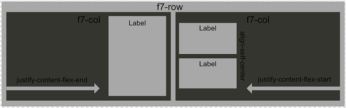

Here is a good post with explanation how to use rows and columns to position items well:
