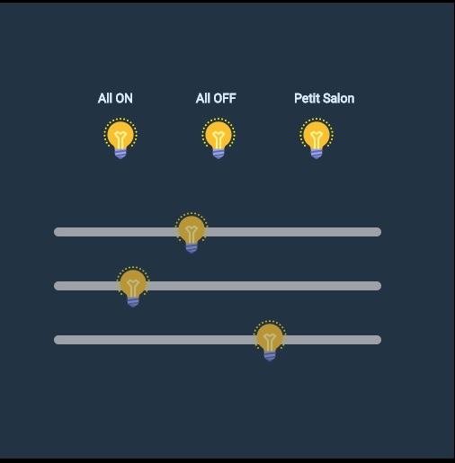

someone know the way to code a http slider to actually send command to openhab? I’ve got a good looking slider but the light doesnt respond.
i try to add ng-click=“sendCmd(‘dimmerGrandSalon’, slider.value)” to the input attribute but it doesn’t do anything.
Also, is there a way to see the code of the standard widget?
here’s what i got so far :
<!DOCTYPE html>
<html>
<head>
<meta name="homeControl" content="width=device-width, initial-scale=1">
<style>
.slidecontainer {
    width: 75%;
    margin: 50px;
.slider {
    -webkit-appearance: none;
    width: 100%;
    height: 10px;
    border-radius: 5px;
    background: #d3d3d3;
    outline: none;
    opacity: 0.7;
    -webkit-transition: .2s;
    transition: opacity .2s;
.slider:hover {
    opacity: 1;
.slider::-webkit-slider-thumb {
    appearance: none;
    width: 48px;
    height: 48px;
    border: 0;
    background: url('/icon/bulb.png');
    cursor: pointer;
.slider::-moz-range-thumb {
    width: 48px;
    height: 48px;
    border: 0px;
    cursor: pointer;
button {
    width: 50px;
    height: 50px;
    border: 0;
    background: transparent;
    color: white;
    font-size: 1em;
    background-image: url("/icon/bulb.png");
table, td, th {
    border: 0px;
  th {
      border: 0px;
      padding: 20px;
</style>
</head>
<body>
<table align="center">
  <tr width="75%">
    <th width="33%">
      <p> All ON </p>
      <button ng-click="sendCmd('allOn', 'ON')"></button>
    </th>
    <th width="33%">
      <p> All OFF </p>
      <button ng-click="sendCmd('allOff', 'ON')"></button>
    </th>
    <th width="33%">
      <p> Petit Salon </p>
      <button ng-click="sendCmd('prisePetitSalon', 'ON')"></button>
    </th>
  </tr>
</table>
  <div class="slidecontainer">
    <input type="range" min="1" max="100" value="0" class="slider" id="grandSalon">
  </div>
    <input type="range" min="1" max="100" value="0" class="slider" id="tableCuisine">
  </div>
    <input type="range" min="1" max="100" value="0" class="slider" id="comptoirCuisine">
  </div>
</body>
</html>

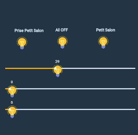

Follow-up on my last post:
I finally found a way to do it:
<!DOCTYPE html>
<html>
<head>
<style>
#dimmer-slider .rz-bubble {
  color: white;
#dimmer-slider .rz-pointer {
  width: 48px;
  height: 48px;
#dimmer-slider .rzslider .rz-bar.rz-selection {
  background-color: #ffaa00;
button {
    width: 48px;
    height: 48px;
    border: 0;
    color: white;
    font-size: 1em;
table, td, th {
    border: 0px;
  th {
      border: 0px;
      padding: 20px;
</style>
</head>
<body>
  <tr width="75%">
    <th width="33%">
      <p>Prise Petit Salon</p>
      <div ng-if="itemValue('prisePetitSalon')=='ON'">
        <button class="btn btn-lg" style="background-image: url('/icon/bulb.png'); color: white" ng-click="sendCmd('prisePetitSalon', 'OFF')"></button>
      </div>
      <div ng-if="itemValue('prisePetitSalon')=='OFF'">
        <button class="btn btn-lg" style="background-image: url('/icon/eye.png'); color: white" ng-click="sendCmd('prisePetitSalon', 'ON')"></button>
      </div>
    </th>
    <th width="33%">
      <p> All OFF </p>
      <button style="background-image: url('/icon/bulb.png'); color=white" ng-click="sendCmd('allOff', 'ON')"></button>
    </th>
    <th width="33%">
      <button style="background-image: url('/icon/bulb.png'); color=white" ng-click="sendCmd('prisePetitSalon', 'ON')"></button>
    </th>
  </tr>
</table>
<div class="slider-div" ng-init='dimmerGSModel={"name": "dimmerGS", "item": "dimmerGrandSalon", "floor" : 0, "ceil": 100, "step": 1,"hidelabel" : "true", "hidelimits": "true" }'>
        <widget-slider ng-model="dimmerGSModel" id="dimmer-slider"/>
      </div>
<div class="slider-div" ng-init='dimmerCModel={"name": "dimmerC", "item": "dimmerComptoir", "floor" : 0, "ceil": 100, "step": 1,"hidelabel" : "true", "hidelimits": "true" }'>
  <widget-slider ng-model="dimmerCModel" id="dimmer-slider"/>
</div>
<div class="slider-div" ng-init='dimmerTCModel={"name": "dimmerTC", "item": "dimmerTableCuisine", "floor" : 0, "ceil": 100, "step": 1,"hidelabel" : "true", "hidelimits": "true" }'>
  <widget-slider ng-model="dimmerTCModel" id="dimmer-slider"/>
</div>
</body>
</html>
That white dot and the fact that the icon is centered are annoying me but overall it’s great!

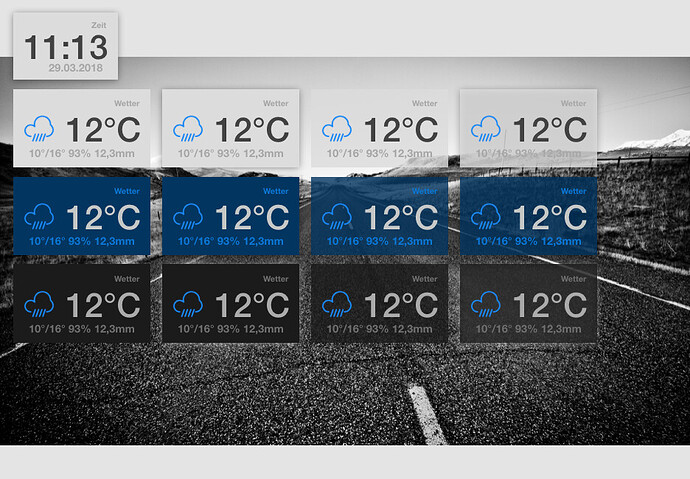

Hey all,
just a little tipp regarding widget or even total dashboard design:
Presentation Tools like Powerpoint or Keynote really do a fine job to play around with colors, fonts and styles. Here is an example I did to create my personal Weather-Widget and try out different designs/transparencies/shadows:
