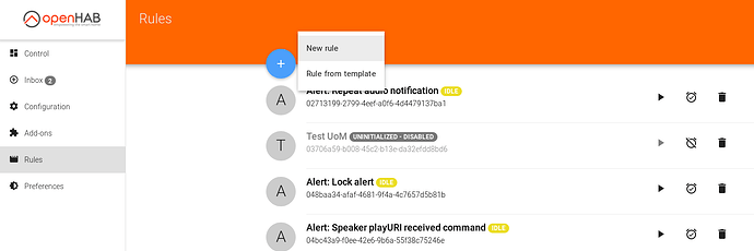

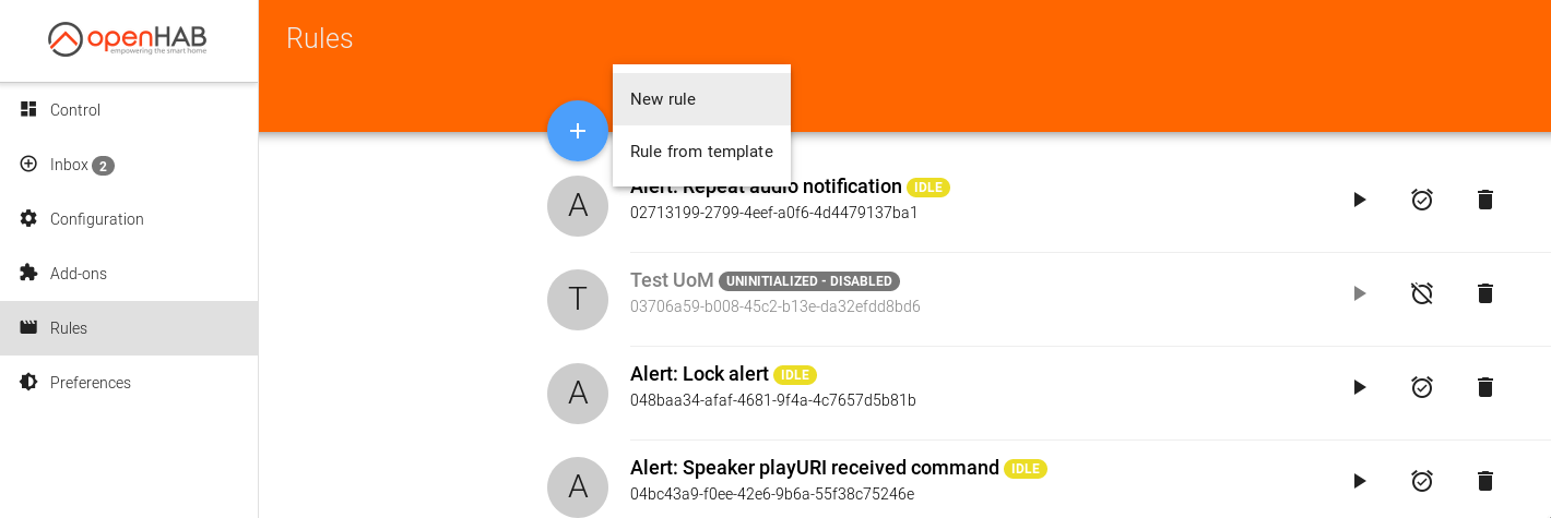

If you install the new rule engine, you can create rules through Paper UI. You also have an option to create a rule from a template.
This functionality has been around for a LONG time, but I do not think anyone from the comminuty has has created documentation for it yet. If you have the Eclipse IoT Marketplace installed, there is an option for rule templates.
