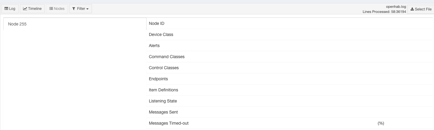

I’ll tried out events.log and obenhab.log in openhab/userdata/logs but the HABmin-log-viewer don’t shows the nodes, only 255.
Thanks - I expected this to be the case, but wanted to be sure as if I misunderstood this I’d be looking in totally the wrong place…
It will only work with the openhab log - or a zwave log if you have that instead (since it is the same as the openhab log, but only with zwave data). Events log is not used.
Can you email me the log you used? I use this here often, so it should work ok… I note that this log only processed 58 lines of the 36000 in the file, so it seems it doesn’t contain much z-wave stuff - or maybe there’s a formatting change somewhere…

The problem with the log is it’s not got debug enabled… I think it you enable debug logging, then the log display will have something to display :slight_smile:.

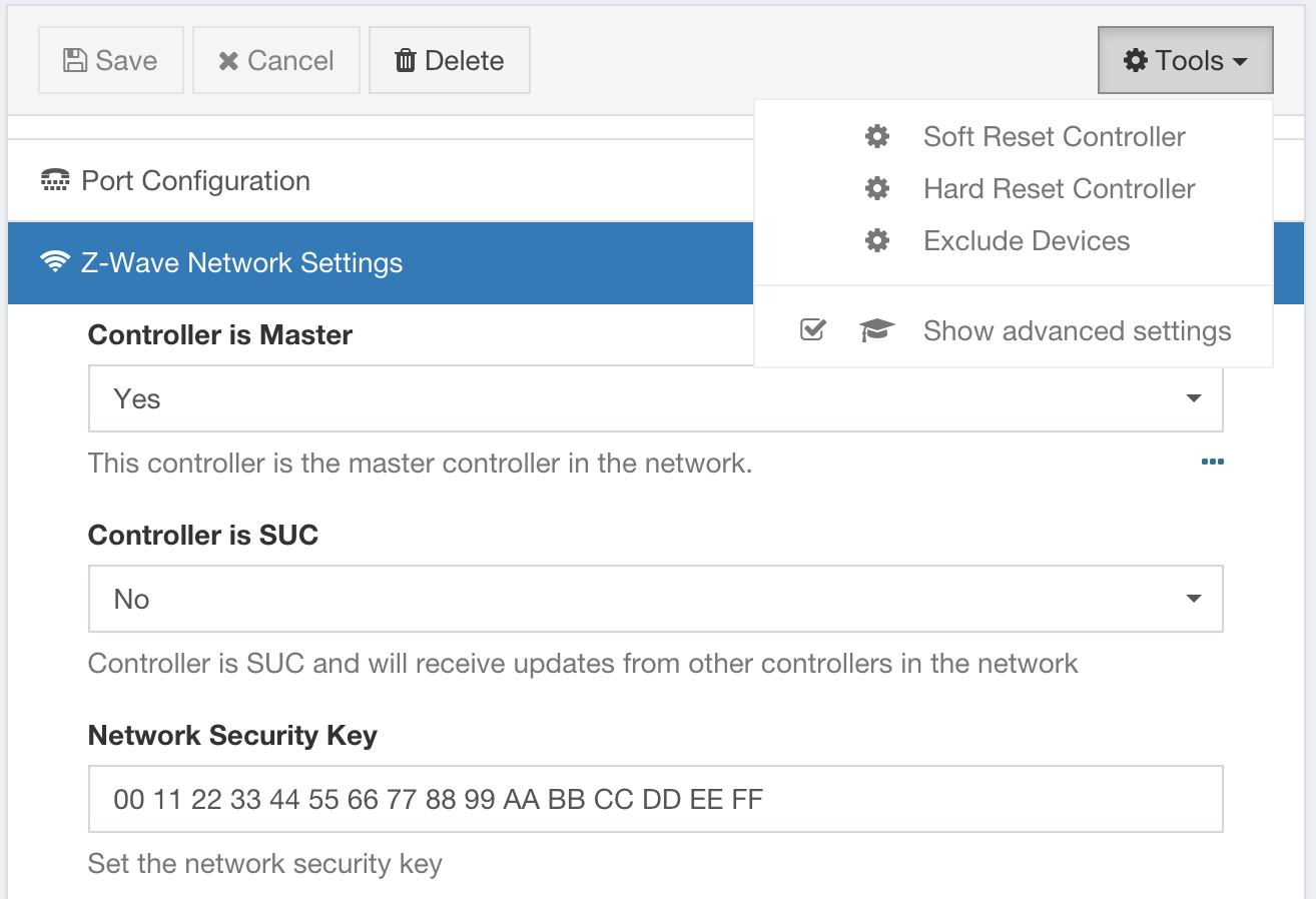

I’ve just merged the secure command classes into the Z-Wave binding. This is based on the huge amount of work done by @dbadia - it’s not had too much testing in the OH2 binding (but that’s why you’re all here - right :wink:) but Dave has had this running for a while now on an OH1 branch, so it should be good…
To use, you need to set a network key in the controller before trying to include the lock into the network. To do this, you need to select Advanced mode from the tools menu, then select Network Settings - see below -:
Start inclusion by clicking on the discovery button in HABmin (note you MUST do this - you can’t include directly to the stick).
You can also find Daves wiki here.
Of course, you also need the database entry - I’ve updated that this afternoon to add DOOR_LOCK support.
Since my lock is sitting on the floor, and not in the door, it’s a bit hard to tell when it’s unlocked and locked - it speaks to me and tells me it’s unlocked and disengaged, which to me are the same thing, so let me know if you find it’s wrong!
