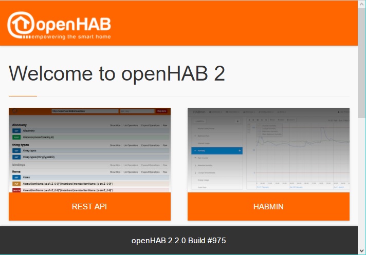

You can update to 2.2.0-snapshot now, #975 will be the first.
Done! :thumbsup:
Get:1 https://openhab.jfrog.io/openhab/openhab-linuxpkg/ unstable/main openhab2 all 2.2.0~20170629133434-1 [53.4 MB]
Unpacking openhab2 (2.2.0~20170629133434-1) over (2.1.0~20170626192651-1) ...
Processing triggers for systemd (215-17+deb8u7) ...
Setting up openhab2 (2.2.0~20170629133434-1) ...
A few seconds later…
2017-06-29 [HELLO] [openHAB2.core.X] - Initialized Core Engines. Turbo Mode Activated !
:slight_smile:
Same to me. Is working.
With my manual #975 install I only got boost mode :joy:
2017-06-29 [HELLO] [openHAB2.core.X] - Initialized Core Engines. Boost Mode Activated, Turbo left for later !
Otherwise: running great so far.
