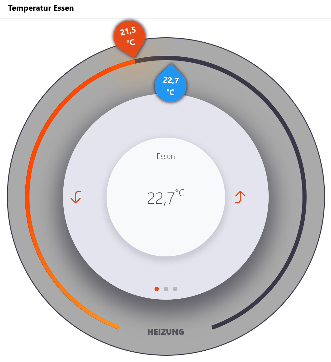

Markus, could you share the page layout type where this is working for you?
And the yaml if convenient.
it’s a standard page

The widget looks good on the 5.1.x branch, i.e. what will become the next 5.1.x patch release, so the fix you observed in 5.2 has been backported :+1:
