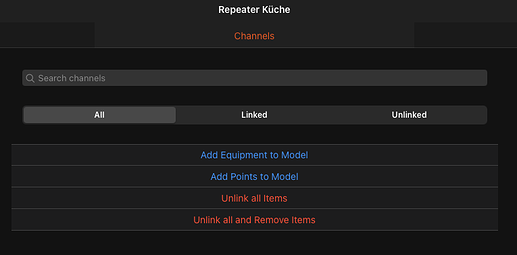

I tried to turn off one of my devices, but it does not work (another device with the same problem):
2021-11-30 20:12:19.727 [INFO ] [openhab.event.ItemCommandEvent ] - Item 'Monitor' received command OFF
2021-11-30 20:12:19.728 [INFO ] [penhab.event.ItemStatePredictedEvent] - Item 'Monitor' predicted to become ON
I tried to restart the deCONZ binding, nothing changed. I tried to reboot the server, but still the sam result. Then I deleted only the thing and added it again via the UI and the channel with a linked item is visible again.
