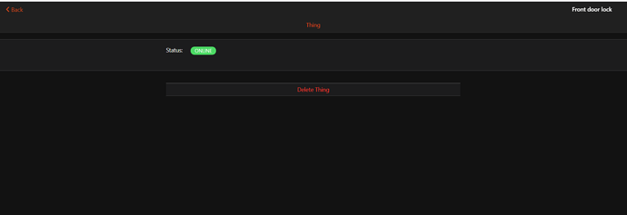

Hi, I have a Thing of a new type that’s currently only in the 3.2.0.SNAPSHOT, so that’s the version I’m running. The Thing type is Heltun HE-RS01 and it worked perfectly well until I rebooted my Pi today.
Now everything still works perfectly well in as much as functionality is concerned – all Items are in place, rules are working etc. but when I try to open the Thing’s page, it’s empty; all I see is that it’s ONLINE and there’s a Delete Thing button.
There are no tabs for the Channels or Code and nothing is listed. The only option is to delete the Thing, which I’m hesitant to do because it’s central to my setup, and also I don’t want to have to do this after every reboot.
Nothing shows in the logs while I open the Thing page.
Does anyone know what might be the problem? Every other Thing page works fine, including other Z-Wave Things.

How about this: I’m inspecting the XHR request in the UI. It’s a GET http://openhabian.local:8080/rest/thing-types/zwave:heltun_hers01_00_000 and the server response is 204 No Content. This seems a bit anomalous, you’d think something would be logged, but nothing shows up (at least not with my current log setting).
Requests to other Things yield the predictable long JSON.
Also I’ve looked in my current Thing json in jsondb, and it’s correctly described there, with all channels, bridge connections, configuration etc. The file has the normal access rights. Any idea why the backend would not serve that particular section of it? Are there some kind of checks in the backend that are now failing and which cause a 204 response?

I just noticed that I have the same issue with a thing. I have no idea when this appeared since I haven’t checked it for years However, all the items connected to the Thing works as before so I suspect it’s just a UI problem (?).
