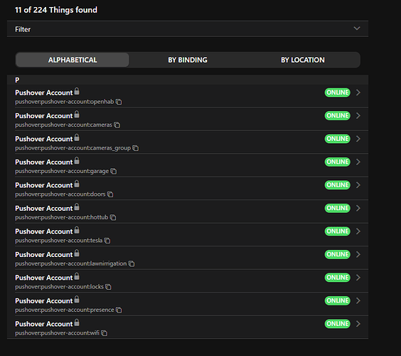

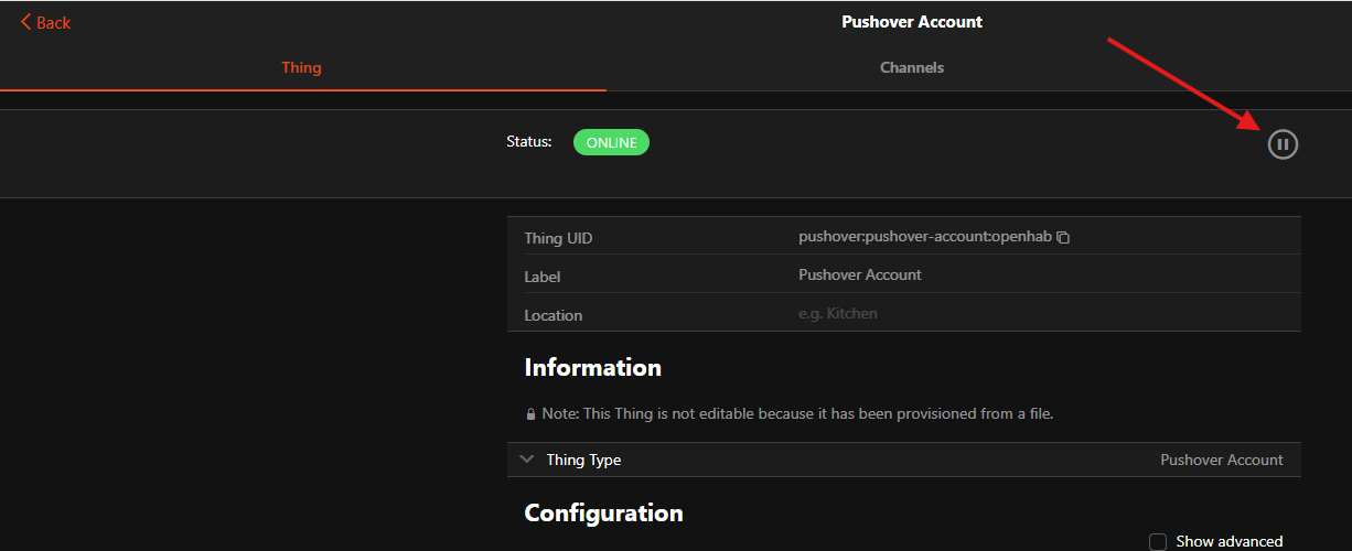

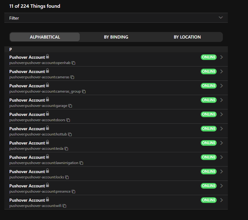

Manually clicking the pause/play button on the THING in the UI causes rule refreshes to trigger, so its not a problem with the actual rule code. I originally thought it was my code untile i manually tested.
