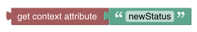

In Blockly you’d use the “get context attribute” block which can be found under the Rule and Process category.

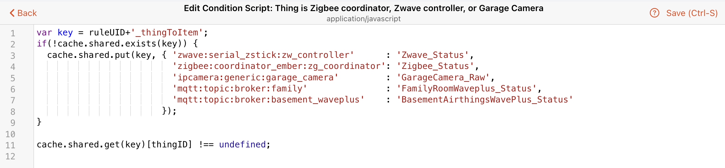

At a high level this rule creates a mapping between Thing ID and Item name and if the Thing changed to ONLINE it updates the mapped Item to ON and OFF for all other states. Everything else is logging.
The rule you see above is the YAML for a managed rule (i.e. a rule created through the UI). Managed rules have some metadata (name, description, etc.) and three main sections (triggers, conditions, and actions).
Triggers should be self explanatory.
At a high level, the condition does the following:
       var key = ruleUID+'_thingToItem';
That sets a variable with a unique value that comes from the ruleUID which is an implicit variable that exists in side of JS Scripting script actions and script conditions. When working with the shared cache it is important to ensure your keys are unique and unlikely to be overridden by some other rule.
        if(!cache.shared.exists(key)) {
          cache.shared.put(key, { 'zwave:serial_zstick:zw_controller'      : 'Zwave_Status',
                                  'zigbee:coordinator_ember:zg_coordinator': 'Zigbee_Status',
                                  'ipcamera:generic:garage_camera'         : 'GarageCamera_Raw',
                                  'mqtt:topic:broker:family'               : 'FamilyRoomWaveplus_Status',
                                  'mqtt:topic:broker:basement_waveplus'    : 'BasementAirthingsWavePlus_Status'
This line checks to see if an entry in the shared cache for key exists and if it doesn’t it populates it with a mapping between Thing UID and Item names. There are other ways to do this but since I have so few Things this was expedient. This mapping is used in the script action too, hence the use of the shared cache.
Finally this line tests to see if the thingID, which is a variable passed into the rule from the rule template, exists in the map. The last line of a condition needs to evaluate to true or false. If false the script action(s) will not be run. If true the script action(s) will be run.
In the UI it looks like this:
or with just the text
cache.shared.get(key)[thingID] !== undefined;
Don’t let the YAML formatting confuse or scare you. The YAML is convenient for sharing a complete rule on the forum but you rarely if ever actually work with it. Instead you work with each part of the rule independently.

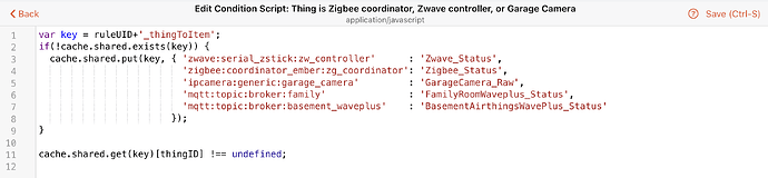

Again, while actually working with the code it will look like this:
console.debug('Thing ' + thingID + ' changed from ' + oldStatus + ' (' + oldDetail + ') to '
              + newStatus + '(' + newDetail + ')');
var itemName = cache.shared.get(ruleUID+'_thingToItem')[thingID];
var newState = (newStatus == 'ONLINE') ? 'ON' : 'OFF';
console.debug(cache.shared.get(ruleUID+'_thingToItem'));
console.debug('Thing status update: ' + itemName + ' ' + newState);
items[itemName].postUpdate(newState);

You don’t even need that. Just define a variable with the same name in Blockly (e.g. Variables - create Variable - “newStatus”) and then use it.

I already pass the Thing Object though. It doesn’t make sense to me to split out each and every property of the Thing and pass that separately if I’m already passing the Thing itself.
that’s a JavaScript view. In Blockly this means you cannot access those properties (except with inline js-code).
I thought for non-experienced users this would be useful but nevermind, was just an idea.
You can’t get the rawThing with the new Blockly Thing blocks?
which ones are you refering to? I only know
And there is no way to call getUID() or getID() except the inline-code-block.
