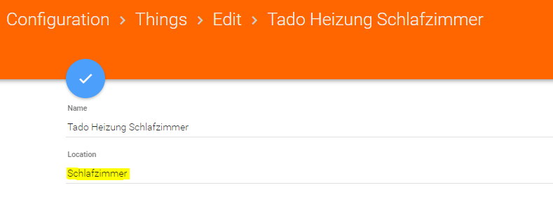

I have to edit my answer. Setting the Location has nothing to do with bindings, as far as I can see. This is a feature from ESH, for all openhab Things. See Location for Things for more information.
I just tested it myself and using @ “Location” works as aspected!
Thing tado:thermostat:schlafzimmer "Tado Heizung Schlafzimmer" @ "Schlafzimmer" [ email="xxx", password="xxx", homeId=xxx, zoneId=xx, useCelsius=true, refreshInterval=125 ]

You are right, it is working in Paper UI + Warning. Just wondered if it can have side effects.
Because I don’t like warnings, I deleted the @ + location :wink:
