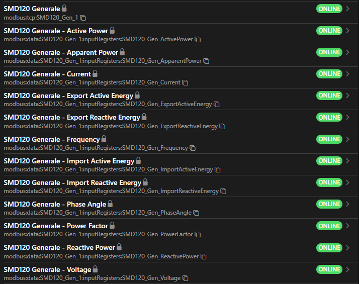

Hi.
Is this the only way?
It’s just so I don’t see the data list along with the things.

Can this be avoided?
mine looks pretty similar except that you don’t need the backslashes.
Ops… that was when I pasted the code…
