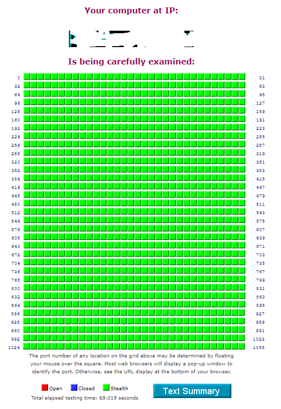

If your interested in checking your system, another good site is GRC | ShieldsUP! — Internet Vulnerability Profiling where you can get them to probe your ports and the info on the site explains what it all means. Click on the PROCEED button and on the next page select which type of scan you wish to do, your also able to specify a custom port range.
Example of what you get back if you have a decent firewall…

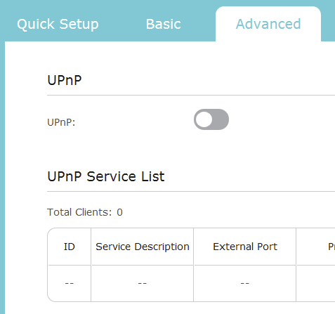

Most routers are automatically forwarding ports via UPnP option turned on.
I recommend: always TURN OFF at each router at first setup. It’s a huge security risk.
