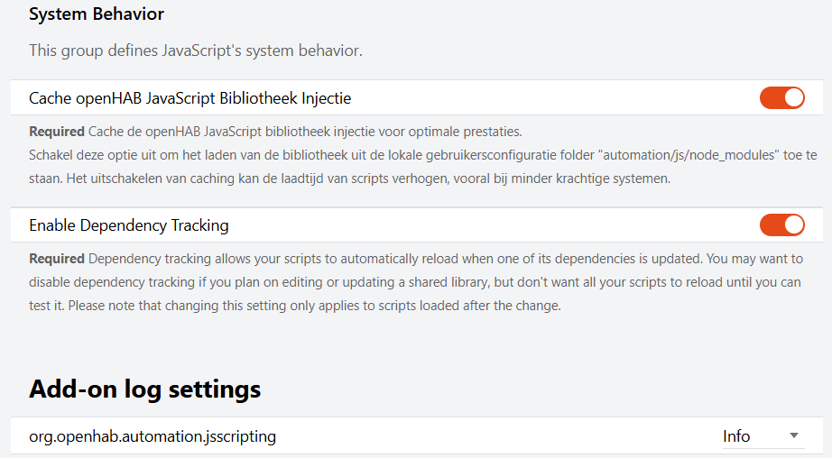

Did you change the settings for the add-on to disable “Cache openHAB JavaScript Library Injection”? If the answer to all of these is no then you are running with the version that comes with the add-on.
There are lots of manual actions I undertake when trying out solutions offered on the forum (or the internet in general). So no idea

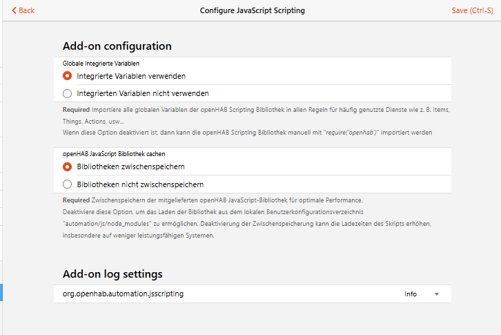

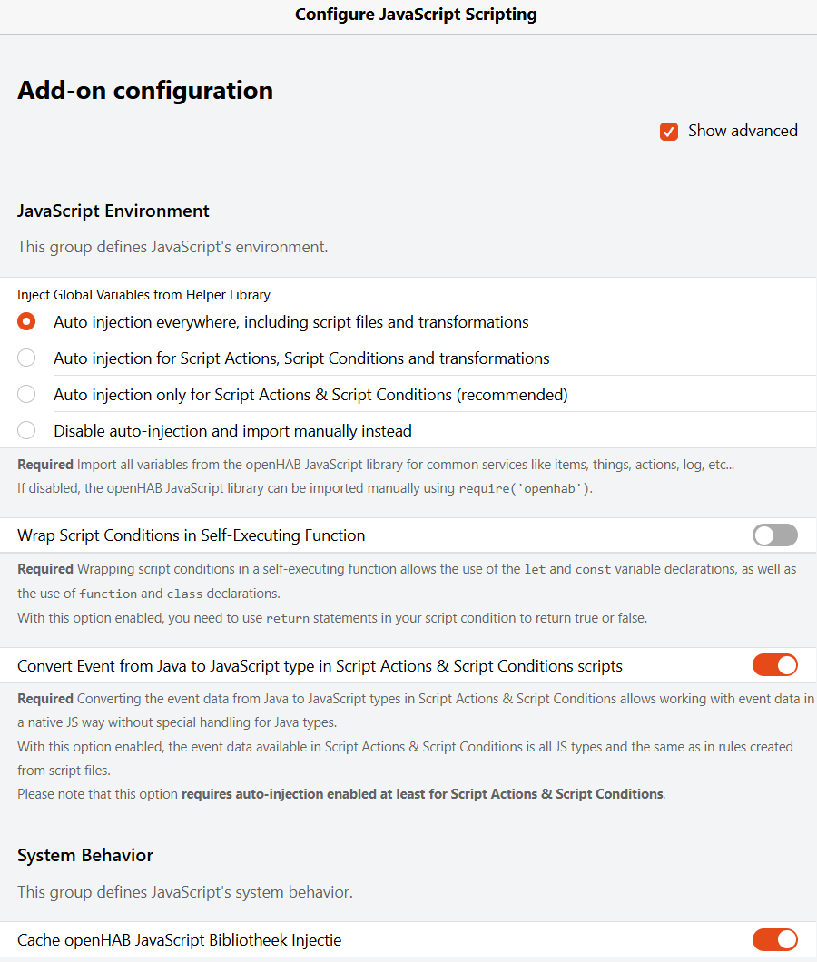

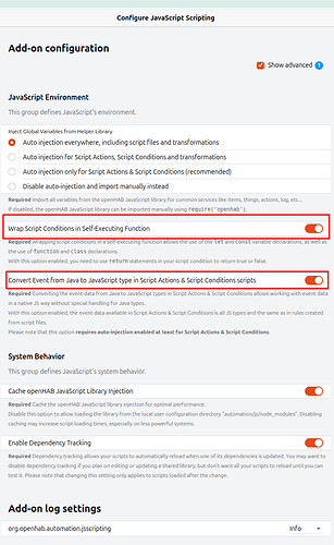

Are you running the latest version of the rule? What are your JavaScript Scripting settings for the wrapper and event object conversion?
I’m not able to reproduce this error. We need to find what’s different between my instance and yours.
I’m running OH 5.11.3 with OHRT 2.1.0. I did reinstall JS and the rules-tools a couple of times and tried both ways via openhabian and the OH add-on store.

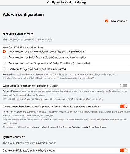

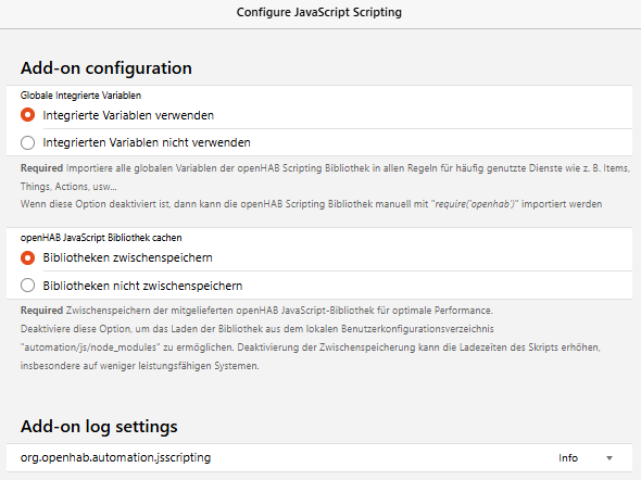

these are my JS scripting settings, but I can’t figure out where to find settings for wrappers and conversions.

There is no such version of OH. Do you mean 5.0.3 or 5.1.0?

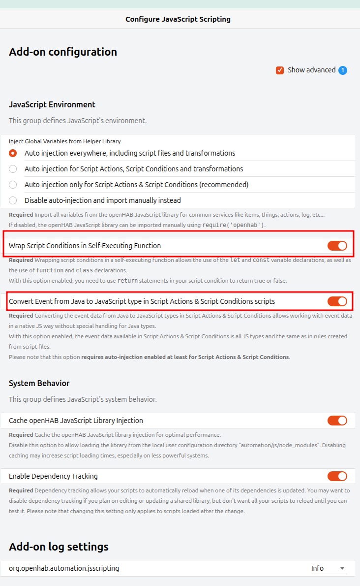

Click “Show advanced” assuming you are on OH 5.1. If you are still on OH 5.0 these settings won’t be there.
sorry, I meant OPENHAB_JS_VERSION is on 5.11.3.
openHAB 5.0.3 - Release Build
openhab-rules // Version 1.7
and so there is no “show advanced”
OK, so the wrapper isn’t available in 5.0.
I don’t have a 5.0 instance to test with.
