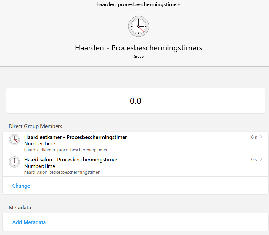

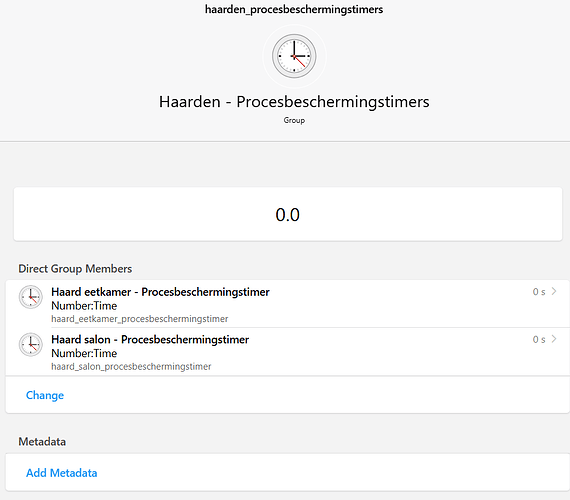

Have you created two seaparate instances of the Threshold Alert rule? Are both triggered by the same Group Item?
That’s going to lead to chaos as both rules will trigger on changes to both Items. If you have soemthing different you want to do between the two Items, you should use metadata to override the properties that are different for each Item, not create two separate rules. Or if you do create two separate rules, the rule must only be triggered by the one Item that rule apples to.
This is more evidence your config is the problem here. But both the salon TA rule and the eetkamer TA rule are triggered by the same Group and that Group has both the salon and eetkamer Items in it, both the salon and the eetkamer TA rule will be triggered by changes to either Item.
Your configuration should be as follows:
  1. Create one Group and add both the salon and eetkamer Items as members.
  2. Create one instance of the TA rule template, configure everything as desired but leave the Alert Rule empty.
  3. Navigate to the salon Item and add Item metadata in the namespace “thresholdAlert” and set the config property of alertRuleID to “haard_salon_procesbescherming_UIT”
  4. Navigate to the eetkamer Item and add Item metadata in the namesplace “thresholdAlert” and set the config property of alertRuleID to “haard_eetkamer_procesbescherming_UIT”
  5. Run the TA rule created in step 2 manually and look at the logs for errors.

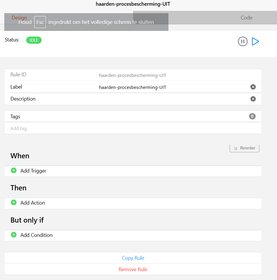

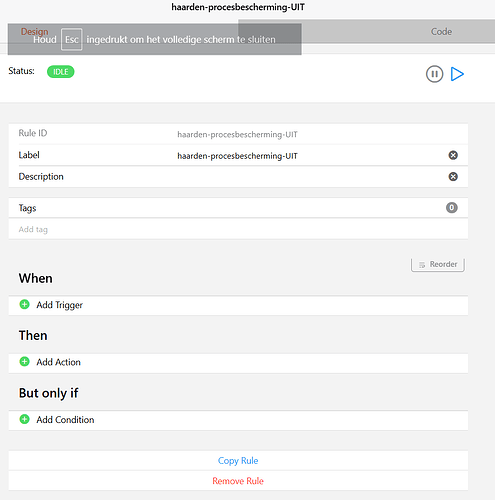

No, there was only the one rule. There was only one rule I switched to DEBUG anyway… I now deleted it, and tried to recreate it following your steps.
I’m not sure what you mean, but there really was only one rule… Now there’s no rule in which haarden_procesbeschermingstimers is mentioned:
If I leave “Alert Rule” (which is registered as “required”) empty, an empty rule is created:

Why are you wanting to call two different rules though, one for each Item. The name of the Item that is alerting, along with a bunch of other information, is passed into your called rule. Assuming these do the same thing just with different Items, why not just have the one rule and figure out which Item to command based on the passed in information?
Overall, this might have uncovered a bug in the rule template (it’s an unusual use case) but I can’t see how. Each Item has it’s own record and that record is passed into a function generator which should fix it when the Timer runs. But something might not work as I think there.
I’ve checked in a new 1.3 version of the rule template which fixes the logger issue in the timer as well as potentially fixes any issue with the record, assuming there is one there.
But a better overall approach would probably be to make your called rule generic. Given your Item naming convention, it’s probably just something as simple as (assuming a managed JS rule):
