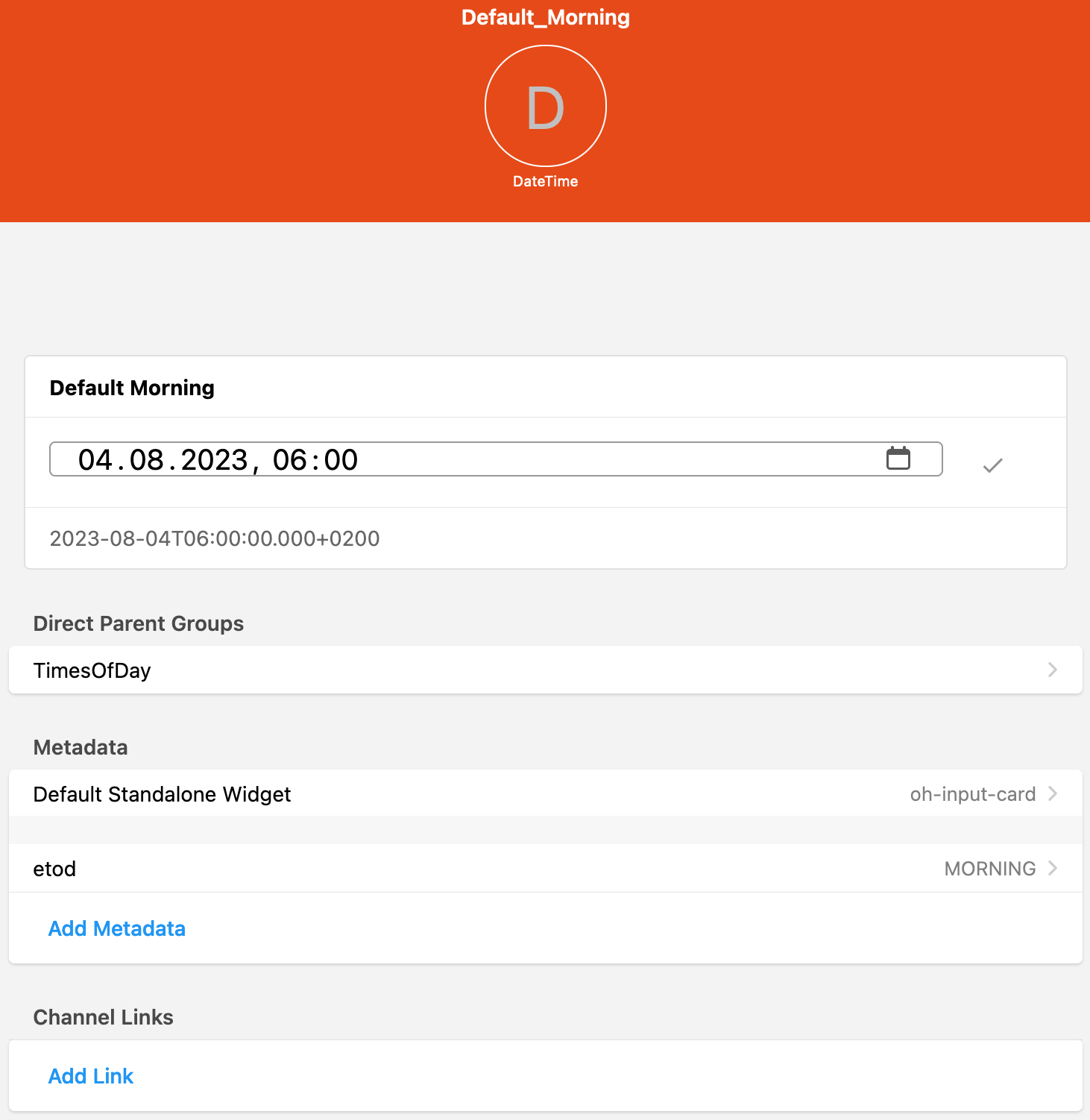

I’m using the OH 4.0.2 release and trying to get the time machine to work. I have created corresponding items and these also have valid values.
When calling the rule I always get this error:
2023-08-24 09:51:59.518 [ERROR] [internal.handler.ScriptActionHandler] - Script execution of rule with UID 'd1bd349ac8' failed: org.graalvm.polyglot.PolyglotException: Error: "2023-08-24T09:52:09.398+02:00[SYSTEM]" is an unsupported type for conversion to time.ZonedDateTime

I have another question, how do I have to create items that should be used on Fridays and Sundays? For example Friday_night 23:30 and Sunday_night 22:50 ?
Heiko

Ok that´s brings me to the next error :slight_smile:
2023-08-24 17:07:26.044 [WARN ] [ore.internal.scheduler.SchedulerImpl] - Scheduled job 'ui.TimeBasedStateMachine.debounce' failed and stopped
org.graalvm.polyglot.PolyglotException: Error: Failed to parse string Default_Morning (Type=DateTimeItem, State=2023-08-04T06:00:00.000+0200, Label=null, Category=null, Groups=[TimesOfDay]): DateTimeParseException: Text cannot be parsed to a Duration: Default_Morning (Type=DateTimeItem, State=2023-08-04T06:00:00.000+0200, Label=null, Category=null, Groups=[TimesOfDay]), at index: 0
	at <js>._parseString(/etc/openhab/automation/js/node_modules/openhab/time.js:149) ~[?:?]
	at <js>.toZDT(/etc/openhab/automation/js/node_modules/openhab/time.js:211) ~[?:?]
	at <js>.:=>(<eval>:217) ~[?:?]
	at <js>.createTimersGenerator(<eval>:216) ~[?:?]
	at <js>.:=>(/etc/openhab/automation/js/node_modules/openhab_rules_tools/timerMgr.js:66) ~[?:?]
	at com.oracle.truffle.polyglot.PolyglotFunctionProxyHandler.invoke(PolyglotFunctionProxyHandler.java:154) ~[?:?]
	at jdk.proxy1.$Proxy1204.run(Unknown Source) ~[?:?]
	at org.openhab.automation.jsscripting.internal.threading.ThreadsafeTimers.lambda$0(ThreadsafeTimers.java:85) ~[?:?]
	at org.openhab.core.internal.scheduler.SchedulerImpl.lambda$12(SchedulerImpl.java:189) ~[?:?]
	at org.openhab.core.internal.scheduler.SchedulerImpl.lambda$1(SchedulerImpl.java:88) ~[?:?]
	at java.util.concurrent.Executors$RunnableAdapter.call(Executors.java:539) ~[?:?]
	at java.util.concurrent.FutureTask.run(FutureTask.java:264) ~[?:?]
	at java.util.concurrent.ScheduledThreadPoolExecutor$ScheduledFutureTask.run(ScheduledThreadPoolExecutor.java:304) ~[?:?]
	at java.util.concurrent.ThreadPoolExecutor.runWorker(ThreadPoolExecutor.java:1136) ~[?:?]
	at java.util.concurrent.ThreadPoolExecutor$Worker.run(ThreadPoolExecutor.java:635) ~[?:?]
	at java.lang.Thread.run(Thread.java:833) ~[?:?]
The items are coming from one of your earlier versions of this rule.
// Default day, initialization for JavaScript should be done thgrough MainUI.
DateTime Default_Morning (TimesOfDay) { etod="MORNING"[type="default"] }
DateTime Default_Day (TimesOfDay) { etod="DAY"[type="default"] }
DateTime Default_Evening (TimesOfDay) { etod="EVENING"[type="default"] }
DateTime Default_Night (TimesOfDay) { etod="NIGHT"[type="default"] }
DateTime Default_Bed (TimesOfDay) { etod="BED"[type="default"] }
I need more coffee.
tod.time is an Item of course. We need the state, not the toString.
timers.check(tod.state, tod.time.state, stateTransitionGenerator(tod.state));
