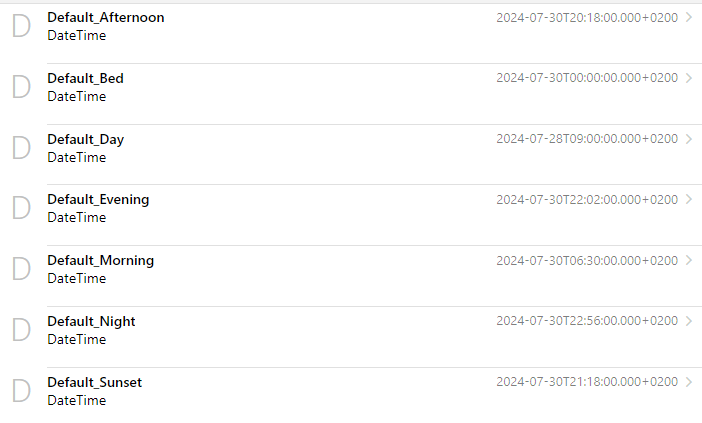

Can you log out what items[itemName].type (line 59) and items[SATE_ITEM].type is in your rule (obviously prior to the if statements)?
Both are still as expected in mine. There was not mention of any changes to the types in the release notes for M2 and I doubt they would have changed as that would be a pretty big breaking change.
Also, just in case, show the definition of the relevant Items (just one of the DateTime Items is fine, I don’t need all of them, click on the edit page and post the contents of the code tab if you are not using .items files.
I really can’t guess why it’s suddenly failing for you and more importantly, how your change actually fixed it.;
NOTE: I do notice that line 117 where I import the StringItem class from Java is superfluous and should be removed.
Of course. That’s what I did to notice that the type is DateTime:
  if(items[itemName].type != 'DateTimeItem') {
    console.warn (items[itemName].type)
    throw itemName + ' is not a DateTime Item!';
Output:
2024-04-09 19:07:32.187 [WARN ] [omation.rules_tools.TimeStateMachine] - DateTime
2024-04-09 19:07:32.188 [WARN ] [omation.rules_tools.TimeStateMachine] - Item Default_Bed's configuration is invalid:
Default_Bed is not a DateTime Item!

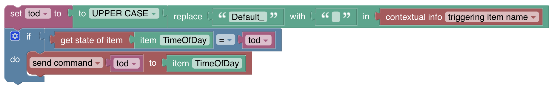

  • Trigger the rule with each of the four time of day Items using the Time is Item trigger to use the time only and ignore the date so you don’t need to update the Item every day
  • The script action in JS for a managed rule would be something like:
var tod = event.itemName.replace("Default_", "").toUpperCase();
items.TimeOfDay.sendCommandIfDifferent(tod);
In Blockly the script action would look something like

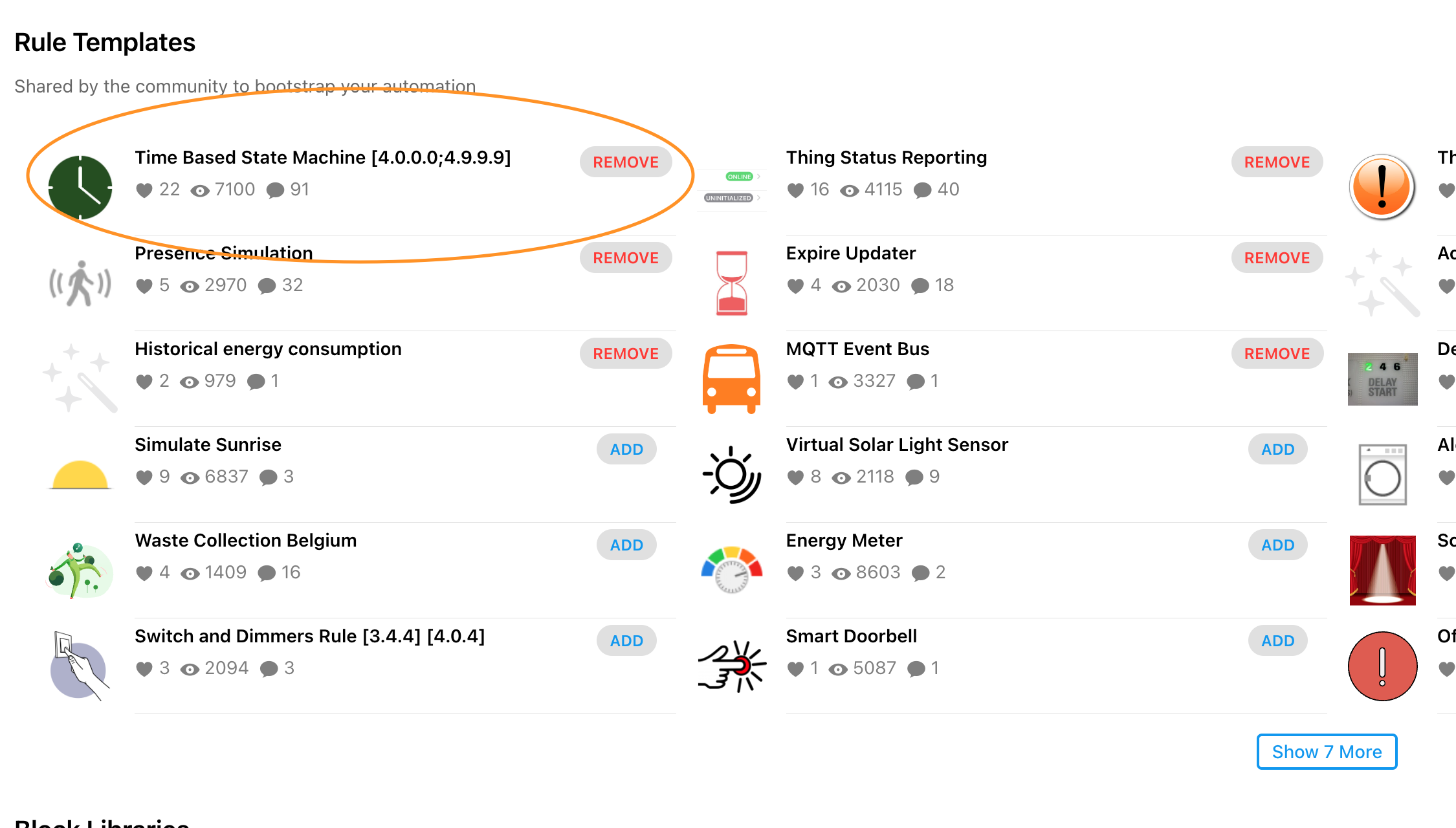

What do you mean you can’t find it. It’s not showing up in the Add-on store? It should be listed under Add-on Store → Automation → Rule Templates
Click ā€œAddā€ and verify that it installs (the ā€œaddā€ will change to ā€œremoveā€). If if fails you’ll get a toast telling you it failed and you’ll see why in openhab.log.

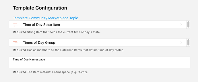

  1. Navigate to Settings → Rules → +
  2. Fill out the rule metadata (ID, label, description, etc.).
  3. Choose ā€œTime Based State Machineā€ as the template and fill out the form
Choose your ā€œTimeOfDayā€ Item from your list of Items for the first one, your ā€œTimesOfDayā€ Item from the list of Items for the second one and enter ā€œetodā€ for the Time of Day Namespace.

All of my Time-Items are DateTime:
I even created ā€œDefault_Bedā€ new from scratch. No success. :frowning:

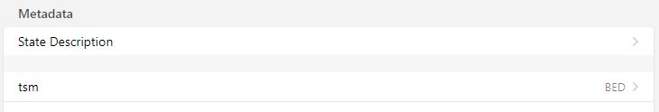

Metadata also is according to documentation (and worked before)
