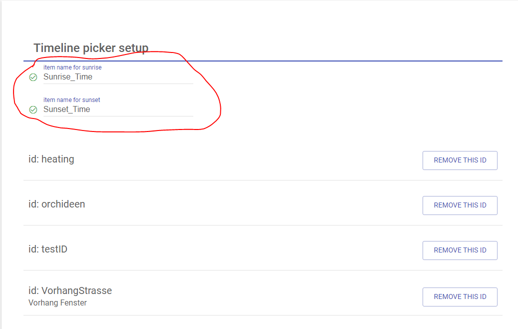

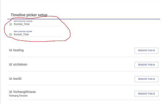

Are you using the sun events?
What i mean are items for sunset and sunset defined in the admin panel of the timeline picker?
Hi Torsten, No I do not use it. I checked all widgets and they are like this:
no, this is not that i mean. In the admin panel you can define items for sunset and sunrise. But when you never tryed this feature … ?
It must be this item:
Can you double check the other items in your tlp_ids.
It’s six. They must only exist and the error messages is quit easy: An item that is called dosen’t exist.
Uhh, I never used this setup page but there are 9 items here.Is it enough if I click on the “REMOVE THIS ID”?
Anyway I removed the non-existing items and now it is OK. Error disappeard and the schedules are working well.

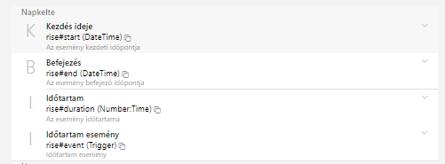

ANother question: If I would like to use the Sun rise/set events than, which chanel should be converted to item? Eg for Sunrise:
This was causing the error message. :+1:
I’m using the channel: rise#start and adjust the switchpoint with the offset here:

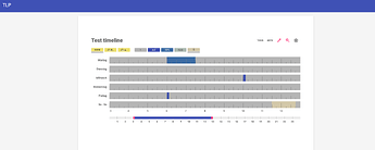

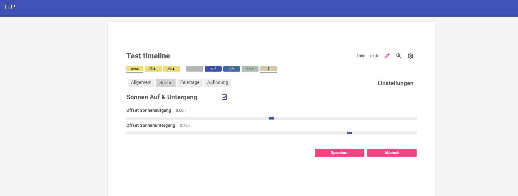

As promised some screenshots of V4:
Figure 1: The main widget; some minor changes for better clarity

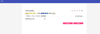

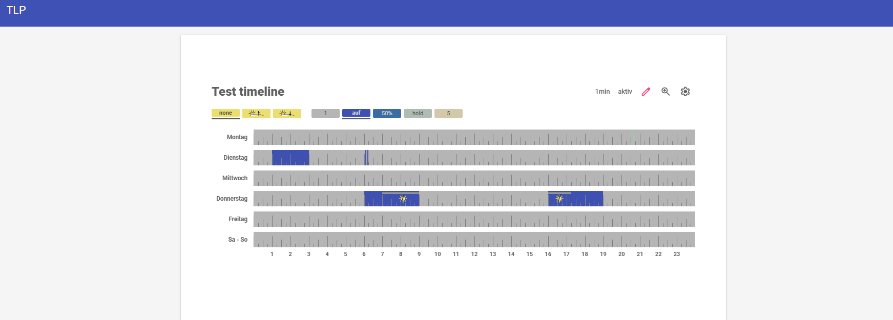

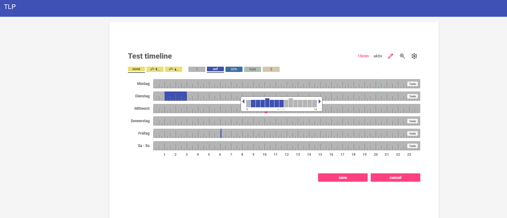

Figure2: Here you can see the extension for 1 minutes. In the ricght upper corner is toggled between 1min and 15min and in each timeline in a button for 1min. When this is pushed (on ‘Mittwoch’ a small timeline for 15 minutes is shown and you can select each single minute. This 15 minutes timeline is moveable over the timeline of the day. On ‘Freitag’ one can see a small selected intervall at 6am.

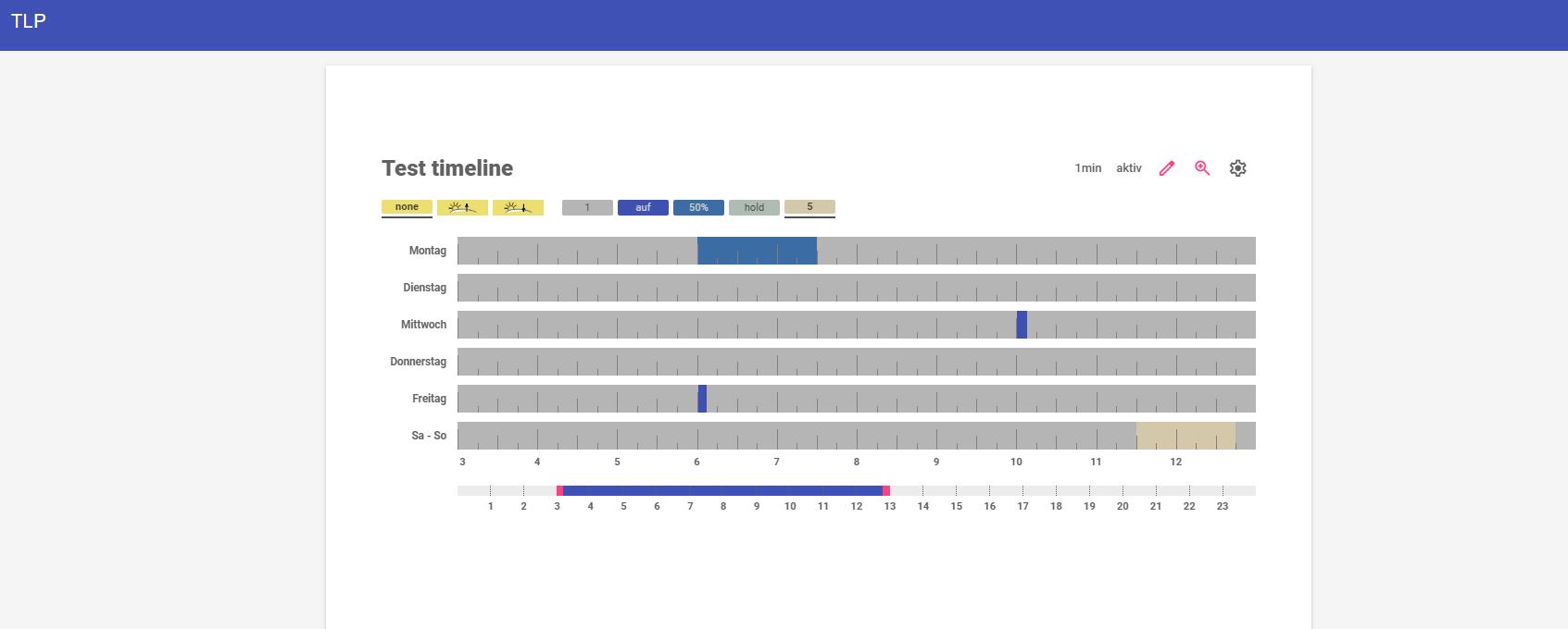

Here you can see the new zoom function. This is complete new and much more useable. In the zoomline on the bottom you can drag the zoomarea (blue) over the day and grab the ends (pink). So the zoomarea is smaller or greater.

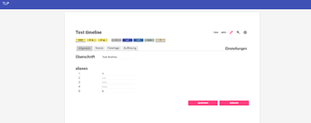

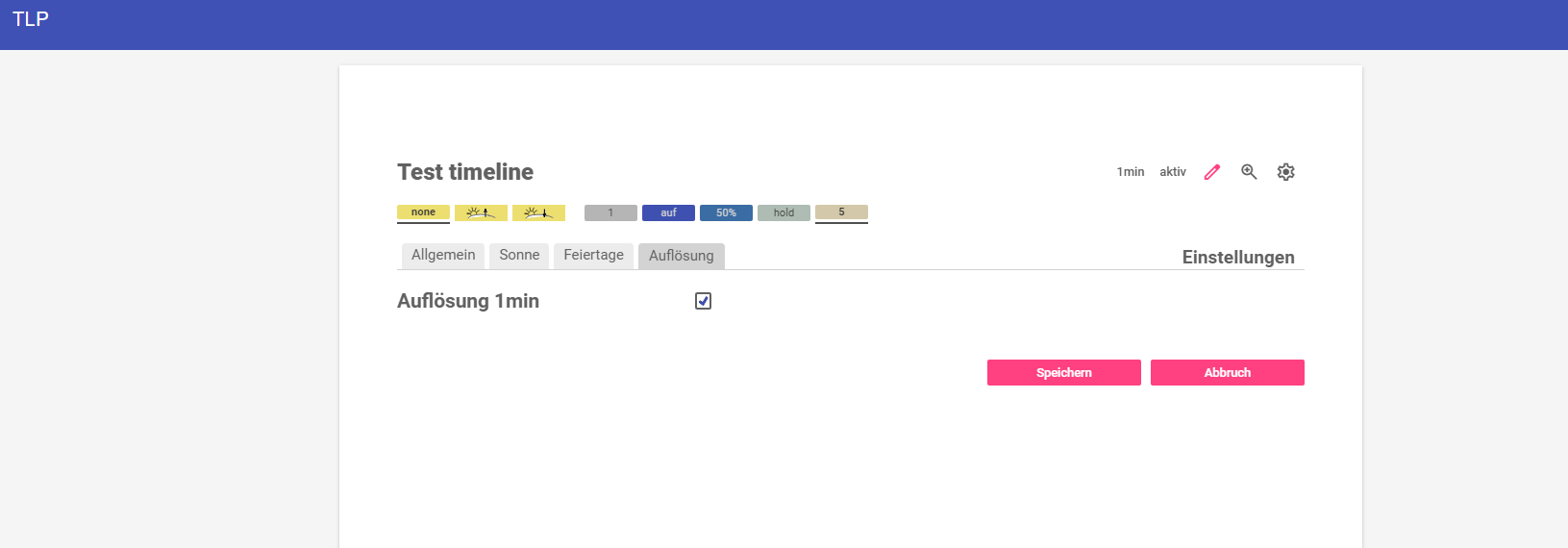

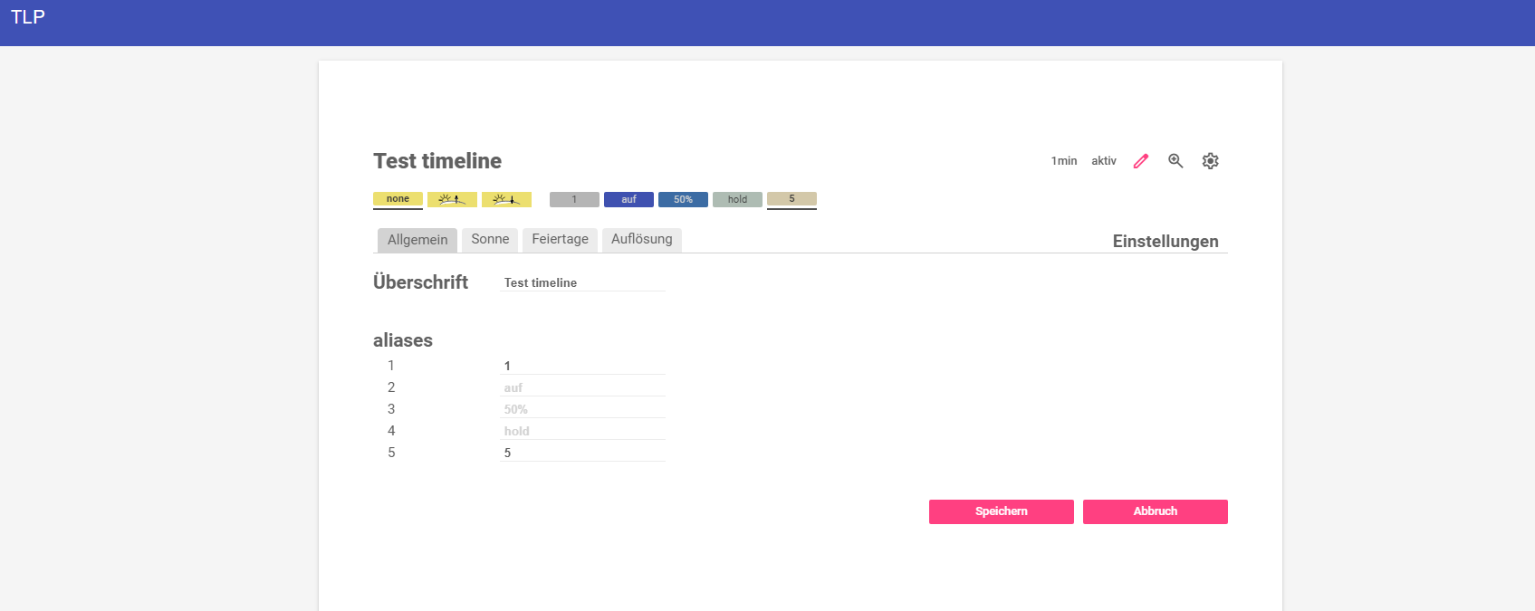

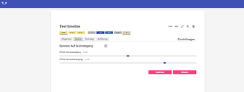

Here are some impressions of the new configuration. All is sorted in tabs.
