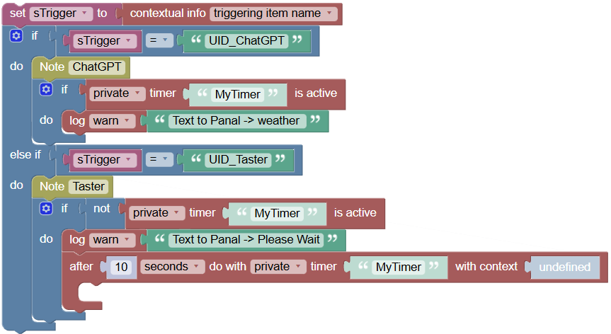

hi,
more background info on the timer requirement:
this is a NSPanel mounted in my guestroom, displaying a welcome screen. the welcome screen can be confirmed with a button that calls another screen with the latest weather information, assembled by chatGPT. usually if a button press does not react within milliseconds, people tend to press it again and again…
the button press will trigger chatgpt to update the nspanel_weather and change to the weather screen. the weather screen is static, that means I need to make sure the item is updated before I call the screen.
my requirement for the timer is that multiple button presses should be ignored after the first button press (this should start a timer and if another button press is detected and the timer is still active it should be ignored). when the chatgpt item is updated, the timer can cancel and the rule should call the weather screen.

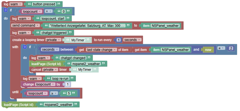

I was able to apply your looping timer, however, I had a mistaken thinking here: as I try to catch the case when the item changed
I do also catch the moment the chatgpt item was fed with input data for processing, which is not want I need to continue the script.
if anybody has a simple idea for how to track change number two within a time range, this would solve my problem.
alternatively I found a workaround by triggering the chatgpt item in a separate rule, independedly from the nspanel scripts…
for a completeness of this post, here is the looping timer which in theory works for items other than a chatgpt item.
I’m not sure if I understood that correctly…
If so - you could equip the rule with the button and ChatGPT alt trigger and react according to the trigger.
PS: for comparisons of numbers like loopcount, it’s better to use math numbers and no text “0”
