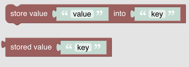

and you can use the following blocks to persist a rule-global-variable that could keep track of you current movement state.
