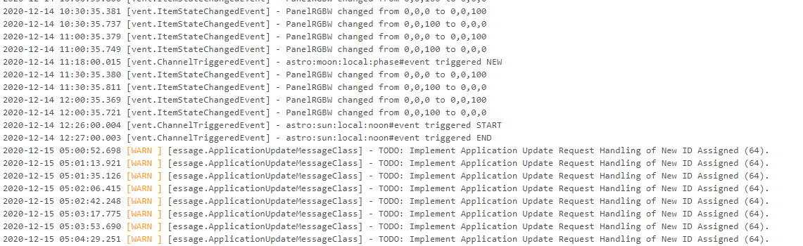

I have been running OH2.5.9 recently updated a week ago, on a pi3B+. I had no issues until the upgrade. I have cleared the cache, and restarted at least 15x. The system runs fine for a period of time, then all of the sudden I get the above. Does anyone have any ideas?

There is obviously something going onā¦I will be away from my computer for most of the day, but am greatful for any suggestionsā¦I will be migrating to a VM, but that will not happen soon, so I need to fix this installā¦
I struggled a bit with the same problem. Although I did a number of things to try fix over days, I believe the solution (for me anyway) was to turn >settings> API Security >basic authorization >ON.

This warning is not related to the web interface - it is a ZWave issue. It means that the binding received a command from a device that it was not expecting and does not proceess.
I did hedge my answer since I made a number of changes. In my struggles I did ID the source of the Warning message in the Zwave binding (ApplicationUpdateMessageClass file.
I had no Warn messages for a couple of weeks after upgrading to OH3 from 2.5.11 with the heal disabled. The message only appeared when I decided to try a network heal. Also it appeared related to the controller, since despite all the warnings, all the other node XML files were updated. What led me to try the API security switch I ran a Debug heal (see attached) and two things stood out eventually (a getConfigDescription) message and the message from your log viewer that the Node 1 neighbors were not updated., so I surmised there might be issues with Put/Get between 2.5 & 3.0 and did see from other postings that this security feature was added.
Anyway heals are working for me now, but it could be something else I did.
This was my starting analysis that narrowed it down for me to the controller and the network heal. The full story of what I did was to delete the OH2.5 controller, create a OH3 controller in the new UI with the same ID as the Home_ID. This meant I has to rediscover all 45 nodes and relink 91 items . However, that alone was not enough. For some reason the OH3 UI controller creation did not include some of the 2.5 controller properties, specifically the Home_ID, so I used the UI Developer Tool of API āPUTā to add them. About the same time I changed the API security switch mentioned above thinking that was what was holding the properties update back. I had hoped that was an easier solution than the ID mismatch. If your problem is the same (canāt tell from the data you provided) compare the ID of the eight digit controller with the Home_ID of the nodes. I donāt know if these need to be the same, but that and the security switch worked for me to clear the WARN TODO.

I did run a Debug 'Heal" with the above changes and the one message that no longer appears is (dest=1 is the controller and callback=64 is what is in the warn message)
