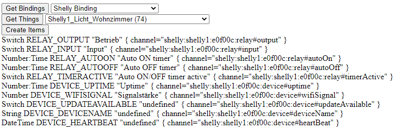

Let’s take a look at an example, here a Shelly device:
In this case I’d like to create 4 items.
PS: I started to build a small web application that allows me to select the Thing for which I want to create the items, but I’m confused on how to detect the item type. For example I see values like “Number:Time” which is not allowed for a *.items file. Fun fact: The REST API provides more channels than displayed via PaperUI (see below)

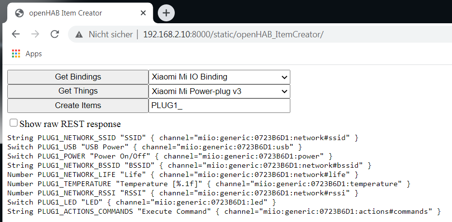

So far I’ve finalized my own tool, which runs inside openHAB as static html page.It even sets the labels correctly, see screenshot below.

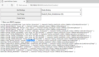

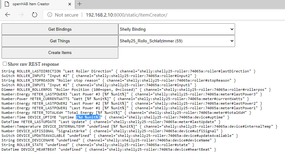

btw: yesterday I fixed a bug
It looks like you are basing the Item names off the channel names. How would that work with a second Shelly? You cannot have 2 Items with the same name.
I’ve modified the sample a bit so you can add a “leading” string to the item names. see screenshot. Taking a look at the example I think something like PLUG1_NETWORK_SSID is much better than something like: MIIO_GENERIC_0723B6D1_SSID. Do you have any other suggestion?
