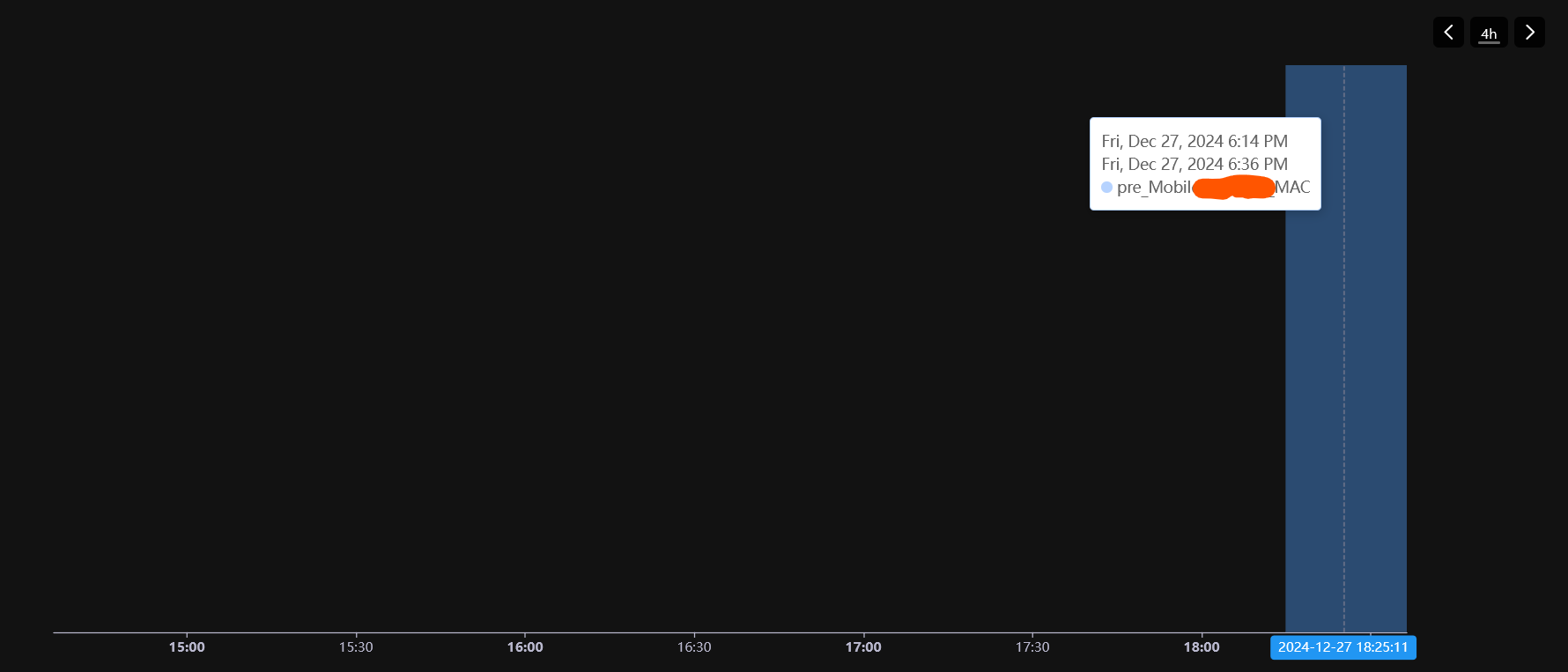

My analysis:

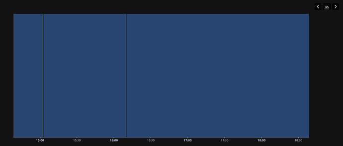

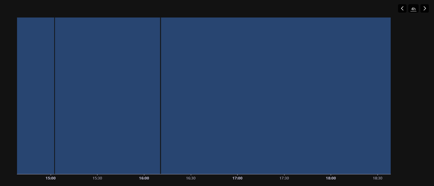

My wife was with me (out) all the time, but her analysis looks like this:
As you can see - something’s wrong
Any help would be great, thanks !
Edit - 28.12.2024:
Interesting fact, I rebooted our fritzbox and switching off the iPhone’s WiFi was registered almost instantly by the TR-064 binding.
Will keep an eye on this…
hey @pilspeda - was only struggling with my new iPhone 16 (IOS 18.4), you need to use your private WLAN-Adress (find in settings of your network) → Use private Wi-Fi addresses on Apple devices - Apple Support - this will solve the issue
