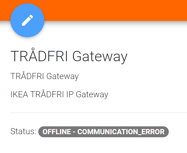

Tradfri 1.8.25 - offline - communication_error

My openhab is pretty much useless for months since the latest trådfri update :frowning:
