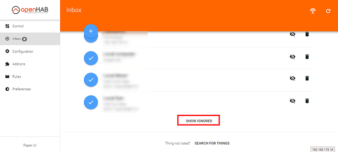

Go to ‘inbox’ in paperui, and click on ‘Show ignored’
using the number mentioned in 1 find the right thing and add (blue V circle)
