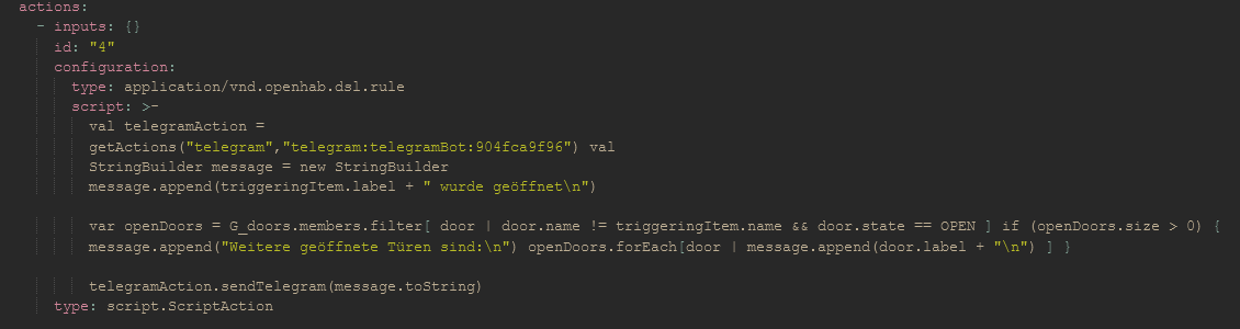

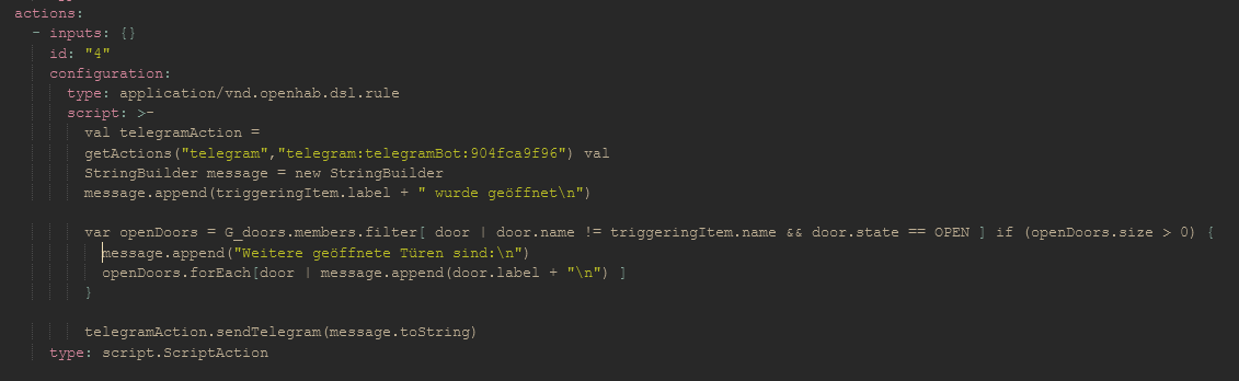

By the way, do you know how I can prevent the code style from being “cleaned up” each time I open a script?
It seems that OH always tries to shorten the script as much as possible and I spent a minute each time I revisit a script to rearrange the line breaks…
Do you mean in MainUI? I’ve not noticed it doing anything like that. The YAML code representation insists inserts two newlines for every one but that is more of a work around for how it gets saved in JSONDB I think. The editor for the script action though she’s it as you wrote it. If you are using some other editor you’ll have to look into that editor’s settings.
Yes, that is what I was referring to with the YAML view. The YAML is basically a direct transformation of what is stored in the JSONDB as JSON. There are some issues with newlines and JSON which need to be worked around.
The only way I’ve found to keep the code consistently on new lines is to have an extra new line for every new line. But I edit the code in the code editor instead of the YAML view.

I only edited the code from the Design tab. The extra new lines were put into the code shown in YAML automatically. And when I remove the extra newlines from the YAML view, the code ends up all on one line in the Design tab.
