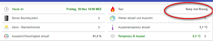

So what you can do to test your item and the corresponding map is:
Login to the shell (via Putty) and then go to the karaf-console. Then enter the following command:
smarthome:send BoilerStatus_str 500_9
This will change the items state and the result will look like in my screenshot (basic ui) above.
