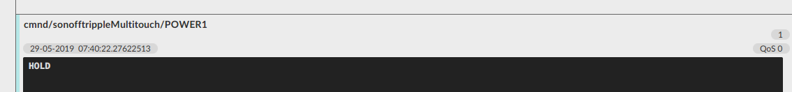

What happends… long press on sonoff 1 does send cmnd/sonofftrippleMultitouch/POWER1 HOLD (checked with MQTT.fx client) but nothing happens. Event log stays empty.

Holding a button 1 produces a command, screenshot from MQTTFx:

BTW, from my understanding now this is not possible. First, if I use MQTT client and issue state/sonofftrippleMultitouch/POWER1 HOLD then state of the item is updated. But if I issue command topic, nothing happens. Further reading suggests this is by design of MQTT and binding. Item LISTENS on state topic but command topic it only uses to SEND.
