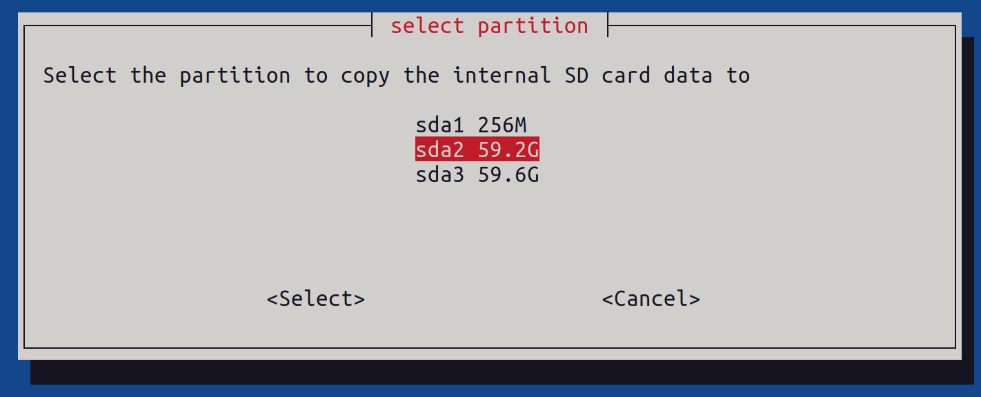

I now did some modifications and wanted to trigger the backup manually before continuing with other changes. I am unsure how to do this.
From what I read in the forum, I assumed it would be as easy as to select sudo openhabian-config -> 50 Backup/Restore -> 55 | Sync SD to trigger an incremental backup. But when I select that, it asks me where I want to backup to, i.e.:
I am unsure, if this is me not using it correctly or if this is an issue with the configuration not being correct. I assumed, I need to select sda2, because that is where the root-partition is copied to (I saw this by mounting it to /mnt using sudo mount /dev/sda2 /mnt ). Also I read that Amanda backs up to the remaining space, which should be sda3, which is mounted /storage:
I would not have expected to be asked where to store at all. I thought that the location where to backup, is what is setup by the auto-backup during the installation or (alternatively) with menu point 53. And that menu points 54 and 55 just trigger the backup to those locations - but obviously this was a misunderstanding.
Also I was unable to find the corresponding information in the openhabian docs … did I miss them?
Any help is greatly appreciated to help me trigger the backups manually …
55 will sync diffs of a single partition (Linux root) so of course you have to select the destination as there’s more than one. But it’s not built to be used like that anyway.
When you have run 53 and keep the external SD plugged, openHABian keeps it synced at any time. If you want to have another full SD copy for off-site storage, use 54.
