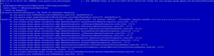

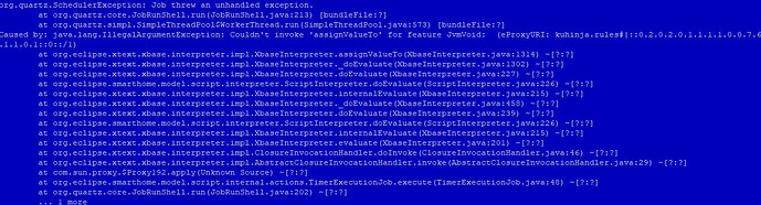

i tried to fix the rule, its kinda working. it does restart timer, but once timer runs out and light is off it wont turn the light on again when someone enters. ill upload a pic of the error
