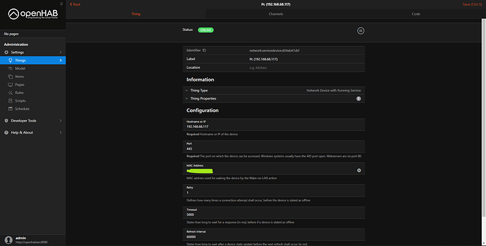

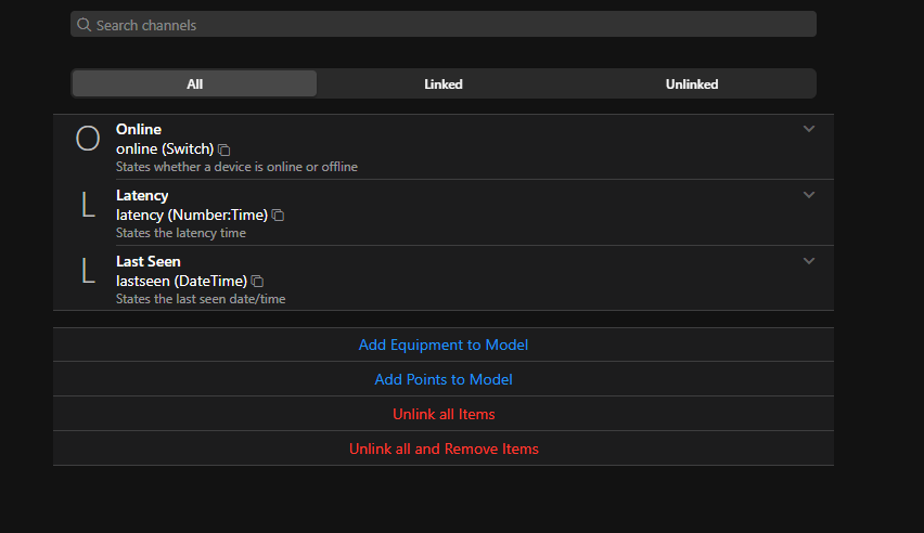

I would share my experience about turn on/off my gaming pc (windows 10) remotely with openHAB. By now I use it daily and is very useful. In the following video I show the final result.
This config is used to simplify lan connection to Nvidia Game Stream, Steam Link or just RDP.
