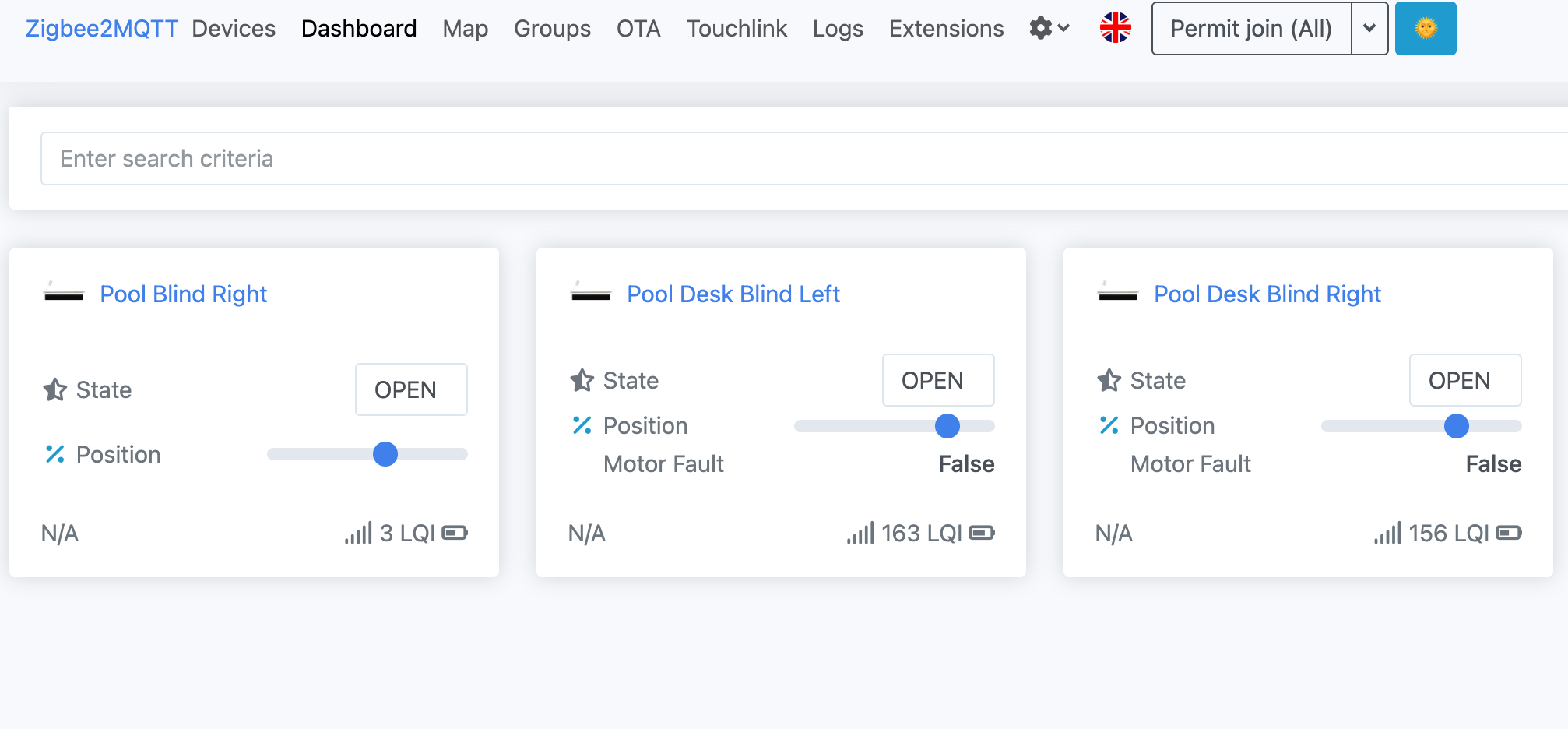

I found my old Sonoff 3.0 stick - and got that up and running again. My blinds are all controllable via the Zigbee2MQTT page, so that’s great. I do have to move my Openhab RPI into the separate building for it to work - but this is much better than when i tried before - my blinds must now be supported properly. I even get battery %age! Hopefully, when the Sonoff Dongle Max arrives, I can just have that in my separate building and put my openhab rpi back!
Just an update…my Sonoff Dongle Max has arrived….and its great! Works perfectly with zigbee2mqtt and Openhab.
Very easy to setup. Great little config website and really easy to enable it as a Zigbee bridge and to use WiFi to connect up to my network and onto my RPI. In z2m you just set the serial connection to the device name and port tcp:/Dongle-M.local:6638 Note though that it’s an Ember device, my old Sonoff 3.0 stick was zstack, so i had to make sure that was selected in z2m.
I have it now positioned in my external building connected to the WiFi and acting as my Zigbee gateway. My Openhab RPI back in its original location :+1:
Zigbee signal is great on all my blinds and the Dongle Max is performing really well. It looks great too, very solid piece of kit with a metal housing. Best Zigbee item I’ve bought!
