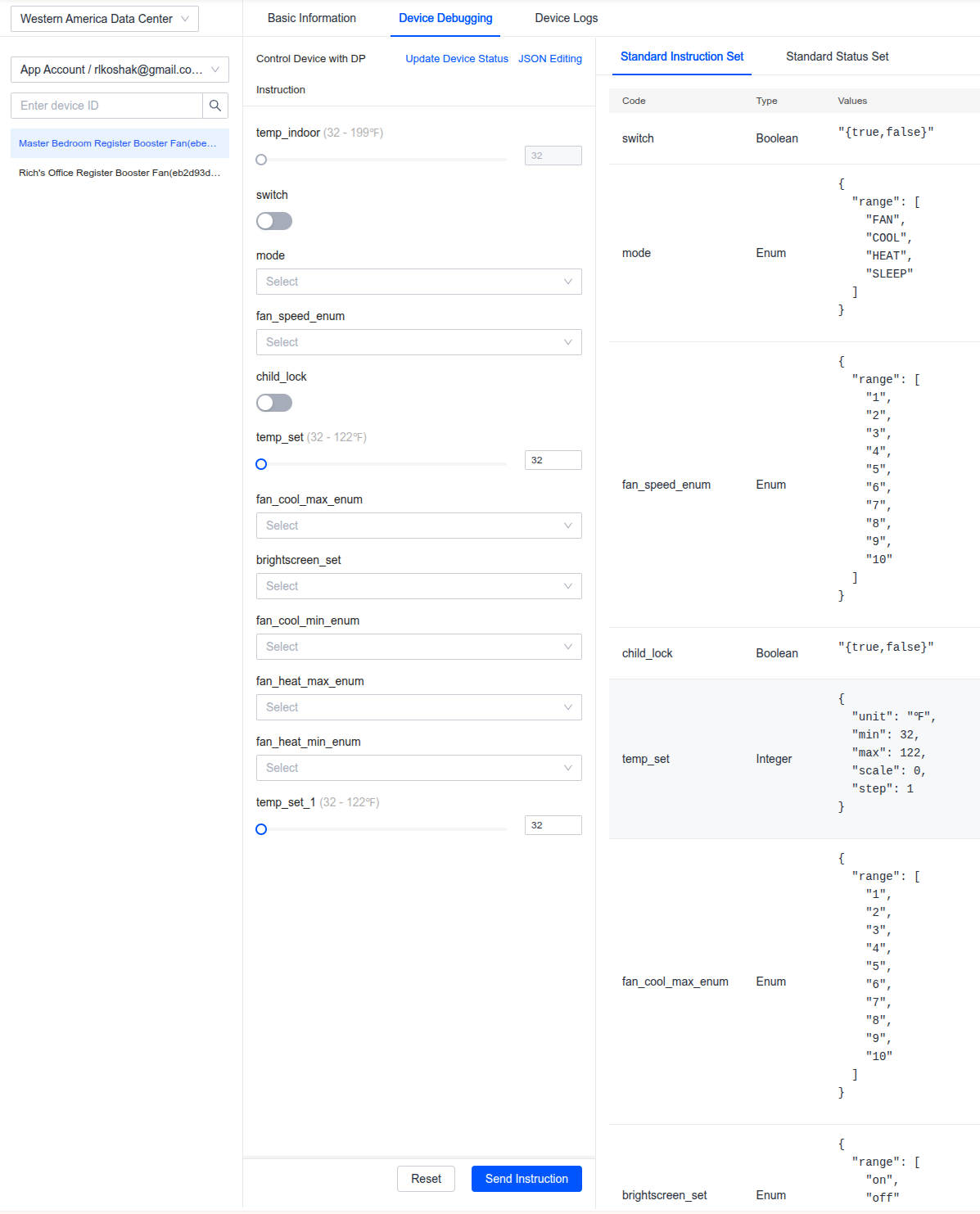

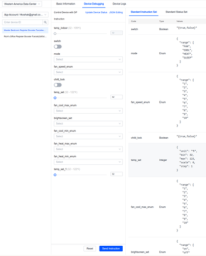

Edit 1: Immediately upon posting I discovered in the Tuya Developer Platform there is a “Standard Instruction” and a “DP Instruction” option. So I might be closer to an answer than I thought. More to follow…
Edit 2: I can see all the control points but still can’t figure out how to discover what the DP number is for each one short of trial and error. There seems to be no rhyme nor reason to the numbering. Do I really need to wireshark this or capture the network logs from the browser?
The answer is no. In the Tuya Developer Platform hover over “Cloud” and choose “API Explorer”. Make sure IOT Core is selected at the top and go down to Device Control → Query Properties. Paste in the device ID and the resulting JSON will include the DP numbers for each Channel. For example:

To find the accepted values for the enums and ranges for the numbers navigate to Cloud → open your project → Devices → Debug Device next to the device you want information about → Device Debugging. That will show you all the valid enums and ranges for each DP.
What I don’t know is whether I need to redescover the Things or what.
So far:
  1. make sure the devices are in DPInstruction mode
  2. discover all the DP numbers for each “channel”
  3. discover the enum values and ranges for each channel
  4. create Channels for the missing ones (I’ve not done this yet, to be continued)
Edit 3: Rediscovering the Thing still only listed the four Channels. But adding the missing Channel I need worked. Woohoo!
