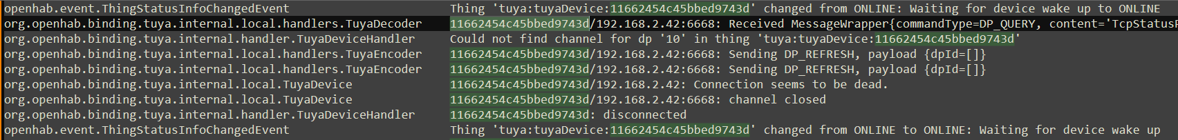

Should be a light device… Maybe switch. Dunno… I will switch over to debug mode as you requested. Overall the log show less information about status change after update. But it’s not fully gone as I show. The biggest problem is that all my lights aren’t responsive enough if I switch many lights in the same time on. Some lights stay off or on after switching. Many thanks for your help! Will send a report ASAP.
info_circle 19:16:56.421	INFO
openhab.event.ThingStatusInfoChangedEvent
Thing 'tuya:tuyaDevice:11662454c45bbed9743d' changed from ONLINE: Waiting for device wake up to ONLINE
ant 19:16:56.435	DEBUG
org.openhab.binding.tuya.internal.local.handlers.TuyaDecoder
11662454c45bbed9743d/192.168.2.42:6668: Received MessageWrapper{commandType=DP_QUERY, content='TcpStatusPayload{protocol=-1, devId='11662454c45bbed9743d', gwId='', uid='', t=0, dps={1=stop, 2=100.0, 3=100.0, 5=false, 7=closing, 8=cancel, 9=0.0, 10=0.0, 11=0.0}, data=Data{dps={}}}'}
ant 19:16:56.436	DEBUG
org.openhab.binding.tuya.internal.handler.TuyaDeviceHandler
Could not find channel for dp '10' in thing 'tuya:tuyaDevice:11662454c45bbed9743d'
ant 19:16:56.566	DEBUG
org.openhab.binding.tuya.internal.local.TuyaDevice
34563405c45bbef59d1a/192.168.2.230:6668: reconnect
ant 19:16:56.570	DEBUG
34563405c45bbef59d1a/192.168.2.230:6668: channel connected
34563405c45bbef59d1a: connected
ant 19:16:56.571	DEBUG
org.openhab.binding.tuya.internal.local.handlers.TuyaEncoder
34563405c45bbef59d1a/192.168.2.230:6668: Sending DP_QUERY, payload {devId=34563405c45bbef59d1a, uid=34563405c45bbef59d1a, t=1769624216, dps=[], gwId=34563405c45bbef59d1a}
info_circle 19:16:56.571	INFO
Thing 'tuya:tuyaDevice:34563405c45bbef59d1a' changed from ONLINE: Waiting for device wake up to ONLINE
ant 19:16:56.586	DEBUG
34563405c45bbef59d1a/192.168.2.230:6668: Received MessageWrapper{commandType=DP_QUERY, content='TcpStatusPayload{protocol=-1, devId='34563405c45bbef59d1a', gwId='', uid='', t=0, dps={1=false, 2=false, 7=0.0, 8=0.0, 102=0.0, 103=0.0, 104=2193.0, 105=1.0, 106=1657.0, 107=30727.0, 108=88695.0, 109=235.0}, data=Data{dps={}}}'}
info_circle 19:16:57.178	INFO
openhab.event.ItemStateChangedEvent
Item 'DDDruckerVyperPower' changed from 65 to 154 (source: org.openhab.core.thing$mqtt:homeassistant_zigbee2mqtt_5F0xa4c1380747f9d023:MQTTBroker:zigbee2mqtt_5F0xa4c1380747f9d023:power)
ant 19:16:57.436	DEBUG
11662454c45bbed9743d/192.168.2.42:6668: Sending DP_REFRESH, payload {dpId=[]}
ant 19:16:57.587	DEBUG
34563405c45bbef59d1a/192.168.2.230:6668: Sending DP_REFRESH, payload {dpId=[]}
info_circle 19:16:58.138	INFO
Item 'DDDruckerMegaCurrent' changed from 0.55 to 0.75 (source: org.openhab.core.thing$mqtt:homeassistant_zigbee2mqtt_5F0xa4c138d7c37833c8:MQTTBroker:zigbee2mqtt_5F0xa4c138d7c37833c8:current)
info_circle 19:16:58.150	INFO
Item 'DDDruckerMegaPower' changed from 70 to 85 (source: org.openhab.core.thing$mqtt:homeassistant_zigbee2mqtt_5F0xa4c138d7c37833c8:MQTTBroker:zigbee2mqtt_5F0xa4c138d7c37833c8:power)
ant 19:16:58.195	DEBUG
bf94f65611a47eb778egyo/192.168.2.68:6668: Sending DP_REFRESH, payload {dpId=[]}
ant 19:16:58.242	DEBUG
bf94f65611a47eb778egyo/192.168.2.68:6668: Received MessageWrapper{commandType=DP_REFRESH, content=''}
ant 19:16:58.436	DEBUG
ant 19:16:58.437	DEBUG
11662454c45bbed9743d192.168.2.42: Connection seems to be dead.
11662454c45bbed9743d/192.168.2.42:6668: channel closed
11662454c45bbed9743d: disconnected
info_circle 19:16:58.438	INFO
Thing 'tuya:tuyaDevice:11662454c45bbed9743d' changed from ONLINE to ONLINE: Waiting for device wake up
ant 19:16:58.584	DEBUG
bf5f8691d4146a6cd2mhbp/192.168.2.74:6668: Sending DP_REFRESH, payload {dpId=[]}
ant 19:16:58.587	DEBUG
34563405c45bbef59d1a192.168.2.230: Connection seems to be dead.
34563405c45bbef59d1a/192.168.2.230:6668: channel closed
ant 19:16:58.588	DEBUG
34563405c45bbef59d1a: disconnected
info_circle 19:16:58.589	INFO
Thing 'tuya:tuyaDevice:34563405c45bbef59d1a' changed from ONLINE to ONLINE: Waiting for device wake up
ant 19:16:58.676	DEBUG
bf5f8691d4146a6cd2mhbp/192.168.2.74:6668: Received MessageWrapper{commandType=DP_REFRESH, content=''}
ant 19:16:59.439	DEBUG
11662454c45bbed9743d/192.168.2.42:6668: reconnect
ant 19:16:59.443	DEBUG
11662454c45bbed9743d/192.168.2.42:6668: channel connected
ant 19:16:59.444	DEBUG
11662454c45bbed9743d: connected
info_circle 19:16:59.444	INFO
ant 19:16:59.445	DEBUG
11662454c45bbed9743d/192.168.2.42:6668: Sending DP_QUERY, payload {devId=11662454c45bbed9743d, uid=11662454c45bbed9743d, t=1769624219, dps=[], gwId=11662454c45bbed9743d}
flag 19:16:59.457	WARN
org.openhab.binding.tuya.internal.cloud.TuyaOpenAPI
Request failed: Result{timestamp=1769624219440, code=1106, msg=permission deny, success=false, result=null}, no token received
ant 19:16:59.464	DEBUG
ant 19:16:59.465	DEBUG

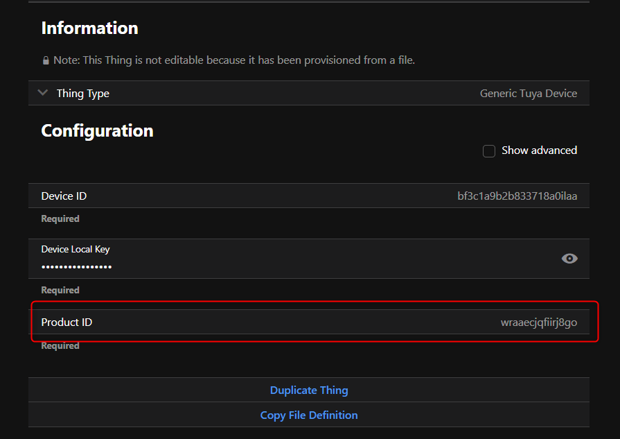

Hope that this will help out. Power plug and a blind.
Can you also, please, provide Product ID for both devices? You can find it in thing:
vnya2spfopsh9lro
3r8gc33pnqsxfe1g
1sge49ixkb5nfhn3

So a quick check on this gives this sequence for one device:
We send DP_REFRESH to get updated state from device two times, but don’t receive any response and coclude that connection is dead. So device is not responding for DP_REFRESH in time. Earlier we had an issue that DP_REFRESH was sent to devices which had no read only DPs, which was incorrect, cause such devices will not respond to it. At the same time your devices have read only DPs, which means they should respond to DP_REFRESH command
So for me it looks like some flaw in device firmware rather then issue in addon itself.
You can also try to enable trace logging and we can check more precisely what’s happening

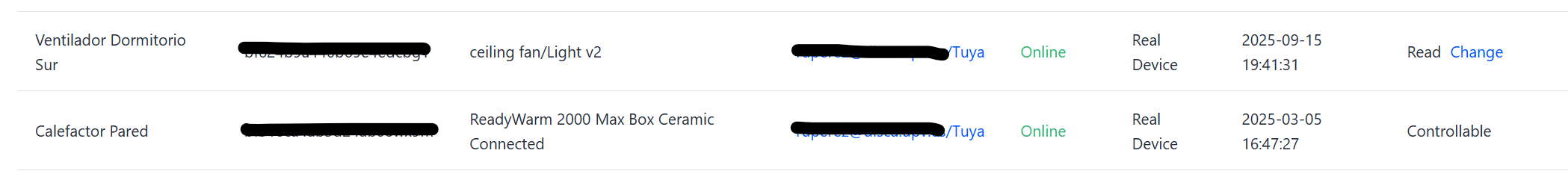

Ledvance Smart+ Matter led bulb
That’s a Matter device not a Tuya device. There is no local Tuya API. You have to talk to it via Matter.
The problem is that I don’t manage to discover using Matter OH Binding, whatever I have tried. This is the first I tried.
After getting bored with Matter, I uninstalled from Smart+ Android App and tried to link with Tuya Smart App, and It worked! I generate a Matter code with Smart +, and discovered with Tuya App, which asked for the matter code. Now it is included in my Tuya Project and it is discovered by OH Tuya Binding, but it is always in this “land of nowhere state” with status Online and message “Waiting for device wake up”
I guess that as it is an WIFI equipment, besides Matter, TUYA should bind it…or not?.
No. The Tuya binding only implements the local Tuya API. It does not implement a Matter API. The binding discovers the device because it is listed by your Tuya Project but has no way to talk to it. Hoping that it will work because the underlying transport is WiFi is like putting diesel in your petrol car and hoping it will work because it uses an engine.
