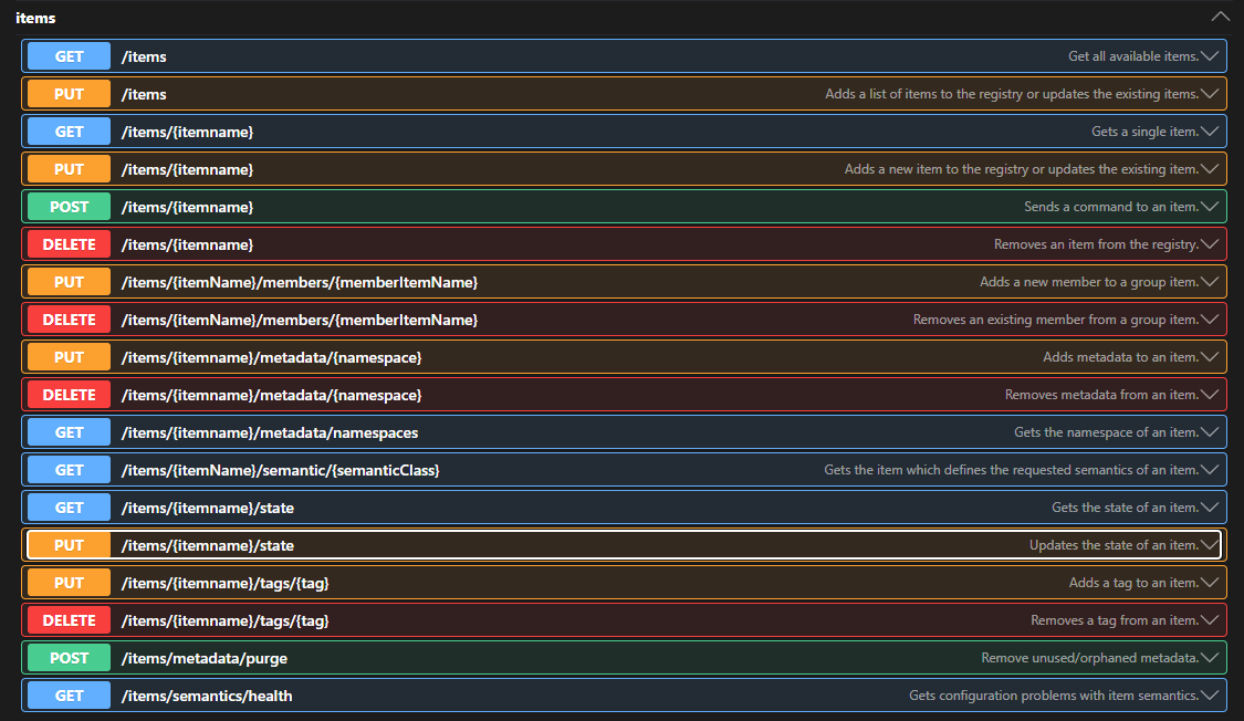

hmmm. Seems kinda strange to send this to a colour item… :wink: But I tried using the API-Explorer:
  • Sending “OFF” to my colour-item => 202 response, but nothing happens
  • Sendinng “20” to my colour-item => 202 response, but nothing happens
  • Sending “gibberish” to my colour-item => 400-error “State could not be parsed: gibberish”
seems, that specific LED at least won’t accept those commands…
but if I send “120.0,90.0,0.0”, I also get an 202 response, but nothing happens. have to try more.

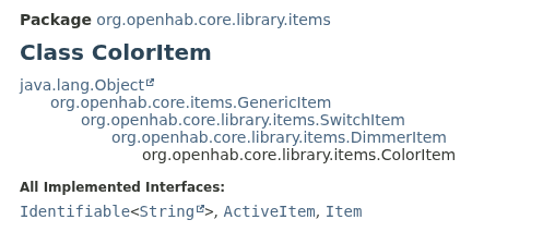

It’s always worked this way. If you look at the code, you’ll see that a ColorItem inherits from DimmerItem which means in all ways it will behave as a Dimmer. In turn, DimmerItem inherits from SwitchItem which means in all ways a Dimmer will behave as a Switch also.
More details in the docs here and here. Notice the commands color accept are listed as
OnOff, IncreaseDecrease, Percent, HSB, Refresh
A few bindings will split the three out into separate Channels, but it’s not required because Color can receive all three.

  • if I use API-explorer the value changes:
    Item 'TeamsLED_Farbe' changed from 309.0,100,100 to 175.0,100,100 but nothing happens
  • if I use items.getItem("TeamsLED_Farbe").sendCommand("30.0,100,100") in a rule, it works. and at least THAT’S all I need to do! :wink:

oh, that works with sendCommand also - but not with the API-Explorer. Perhaps that one only does postUpdate?
There is a separate REST API endpioint for updates and commands. Are you using the PUT or the POST endpoint? A PUT to /items/{item name}/state updates the Item. A POST to /items/{item name}/ sends a command.
I only have the PUT-version in the list? which would explain the behaviour, of course.
Look at the fifth row. “POST /item/{itemname} Sends a command to an item”
