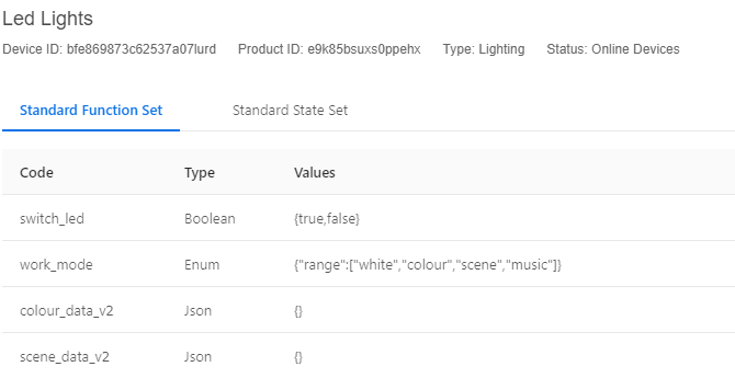

On iot.tuya.com, i found the following additional data if that helps:
I have been able to find color using “tuya-cli get” command line, but I could never get the “set” command to work. It looks like this:
$ tuya-cli get --ip 192.168.0.174 --id bfe869873c62537a07lurd --key xxxx --all --protocol-version 3.3
{ dps:
   { '20': false,
     '21': 'colour',
     '24': '000503e803e8',
     '25': '06',
     '101': 62,
     '102': '0001a401fe',
     '103': '01010101000603e8000503e8',
     '104': '03' } }
