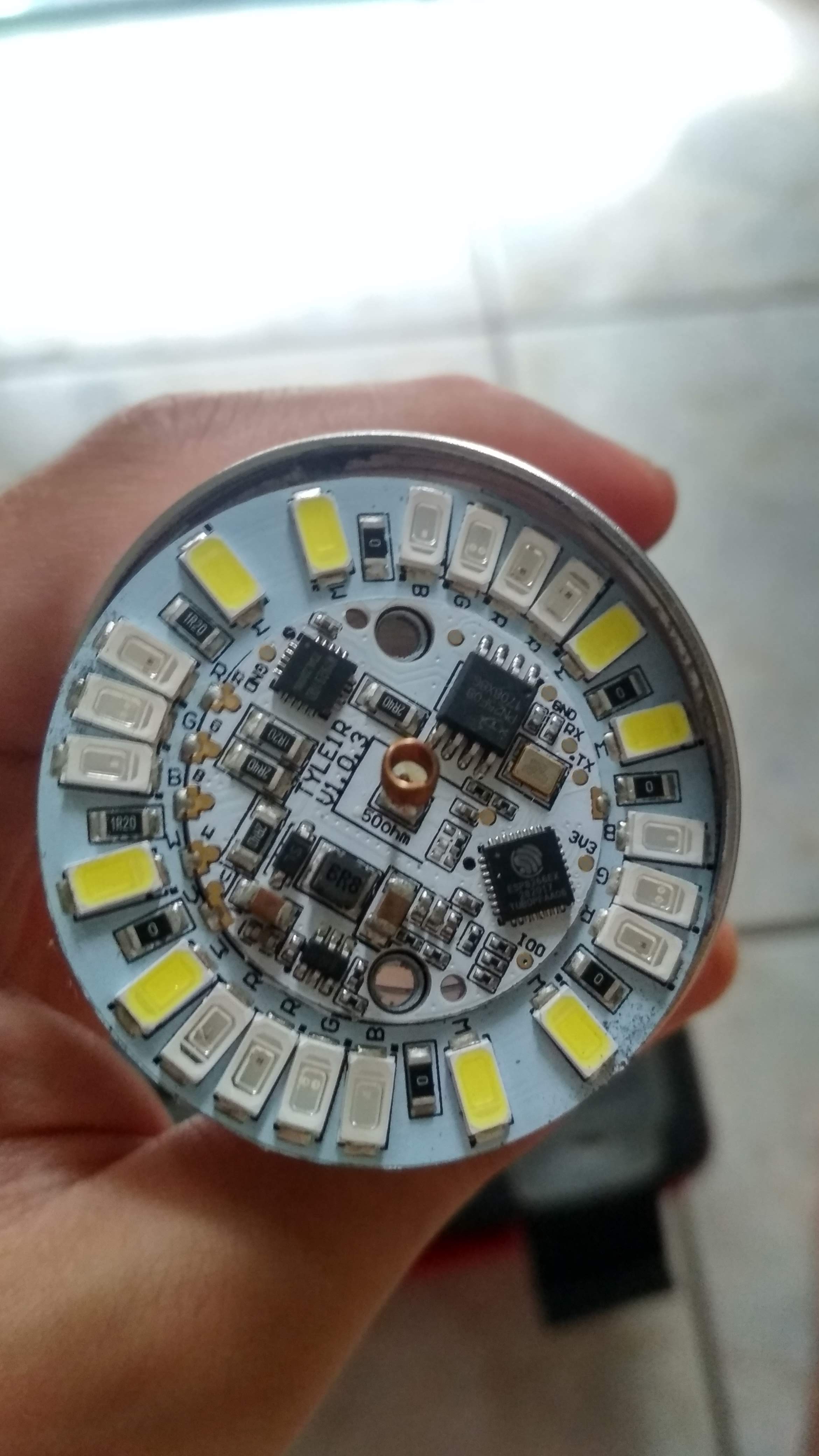

I’ve posted here a light bulb that I flashed with tasmota:
It’s worked pretty good with ESPurna and Tasmota.
