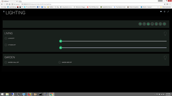

Thanks Harry that seems to be working OK then. Ill test it a bit more.
Do you know why my switch doesnt turn on when the dimmer is more than 1%? Ie I used to be able with the FIbaro Zwave dimmer just drag the dimmer sliding and anything over 1% would turn the switch on?
It doesnt seem to do that.
I have the dimmer and switch linked to the Dimmer channel (switch_dimmer) in PaperUI
