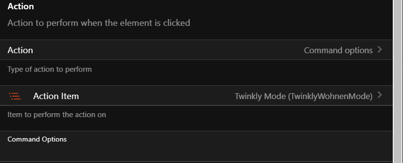

Sure, I will play around with it a little bit. I’m not sure if you saw the last thing I added about Google Assistant.
Now if I would add the switch I would only be able to turn on/off. If I add the dimmer I would only be able to dim, not turn on/off. The optimal would be to bind the dimmer to Google Assistant but then the binding would have to be changed to use these on/off events I think.
Because I do not need to care if it’s movie/effect when using the dimmer slider. It simply works on both devices. If that could be sorted out I think the experience would be better :slight_smile: I can see if I have to to have a look as well some day. Time is rare…
If you’re using GA you can use both Switch and Dimmer, please look here for more information:
For your Icicle you should be able to combine both existing Items as described.
For your Gold you can use something like that:

Hi @Koechi
You might need to send another command to your mode Channel instead of using switch.
In your sitemap you can create a new cell with Send Command action for this Channel, which should probably be on or effect
BR Pav
