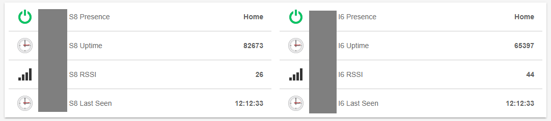

Latest binding seems to be working fine for me. My controller seems to keep updating the last seen value for some time, however. I think someone else mentioned theirs behaving similar at some point. The result being that it is no quicker or more consistent than using the online channel.
After first updating the binding I did a test by turning of wifi on my phone. That worked as expected. Shortly after my configured time out it reported offline. In normal use (just leaving the house) that doesn’t seem to be the case though. I’m not sure if the AP and phone are trying to maintain the connection. Maybe the AP sees that the connection slowly faded so it keeps the device “active” in expectation that the device will come back in range. Who knows.
