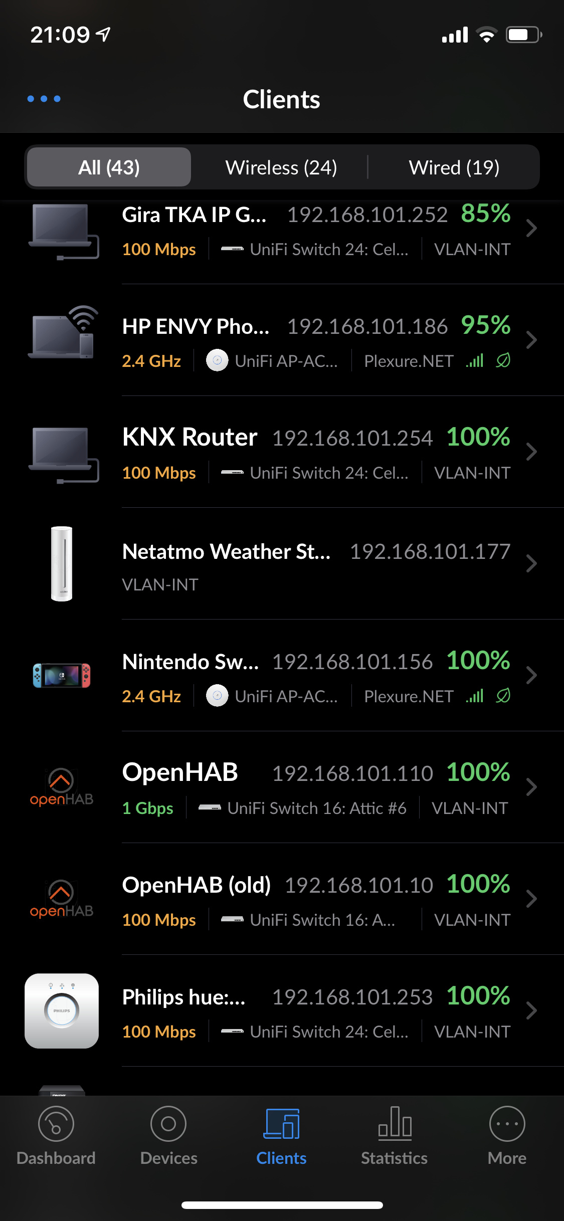

Hi there,
I confirm that I did witness the same behavior on my side a couple of times, but I cannot explain myself how this comes. It’s not linked to the device I think, as I currently have it right now with my Netatmo Main Station (which is WiFi only, but UniFi reports it as being connected using RJ45 to a specific VLAN).
I confirm that I also had it already with my iPhone but so far it didn’t bother me, so I didn’t even watch out to understand the issue.
See example in screenshot:
I just wonder if it’s the UniFi database which might be a bit inconsistent. I saw the issue again after I did some work in UniFi (assigning the device icons, reducing retention periods, …).
I’ll try to run a compact DB and restart the portals and keep you posted.
In terms of the binding I don’t know if it has an impact as I do not actively use the configured devices (yet).
David
Well, no luck … after compacting and forgetting the device, it reappeared, still as a wired device.
It says it’s connected to the port to which the AP is connected - what is not really wrong, but still not the expected behavior.
