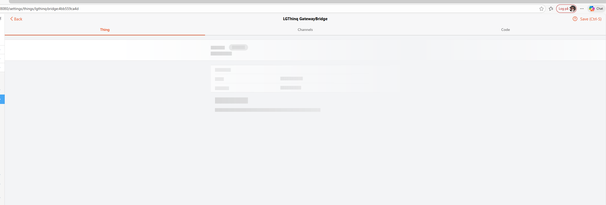

Almost all my things are running fine, also rules etc.. Its just that I cant enter anyone of my Things.
I have the frontail logging running all the time. So I know the events are working just fine.
This is how it shows when I try entering a Thing in MainUI. And it just seems like its reloading all the time never showing the Thing and its settings.

Ignore the modbus warnings.. Those are just timeouts.
I simply have no idea how to get those errors fixed, when I cant enter the Things.

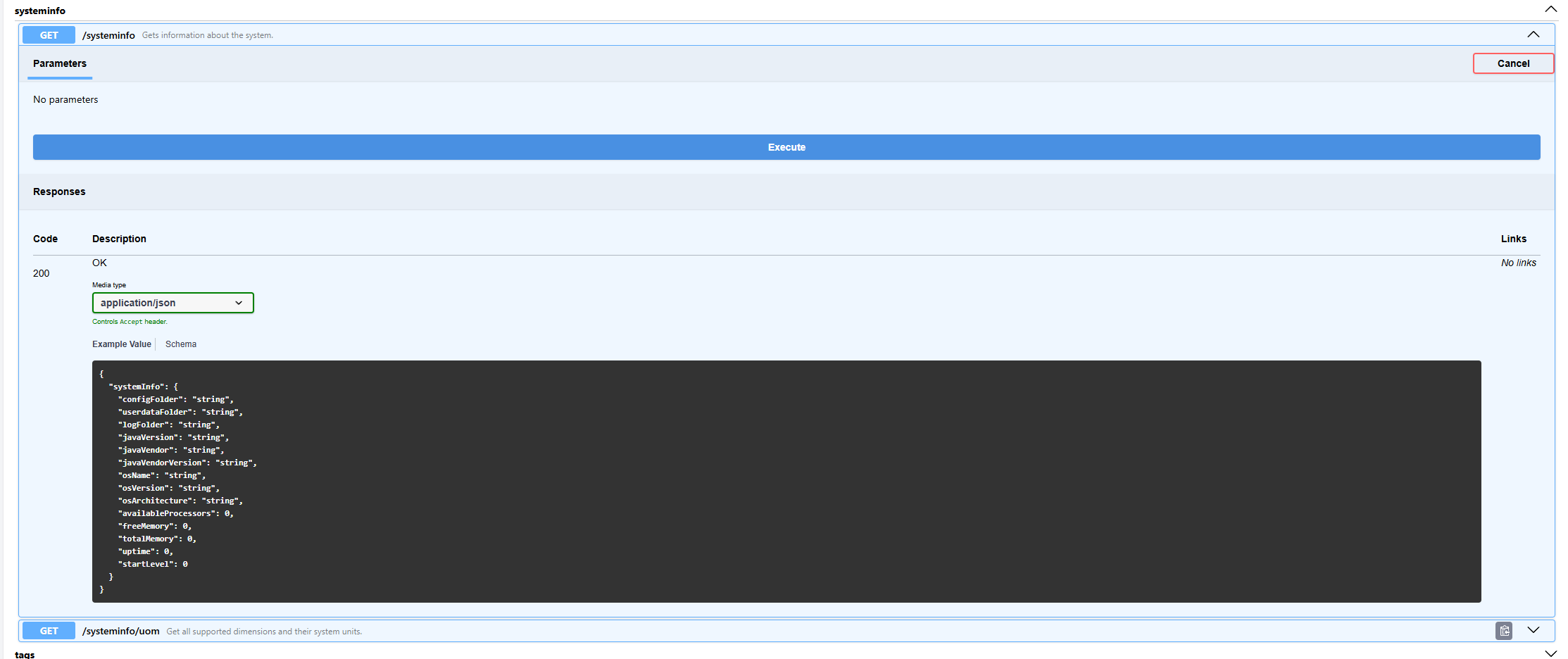

Can you point me more exactly, as I have no idea where the API explorer is?
Is this what you mean?
This is the result when I execute
