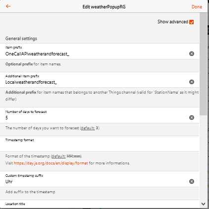

Widget-Settings:
grafik
grafik

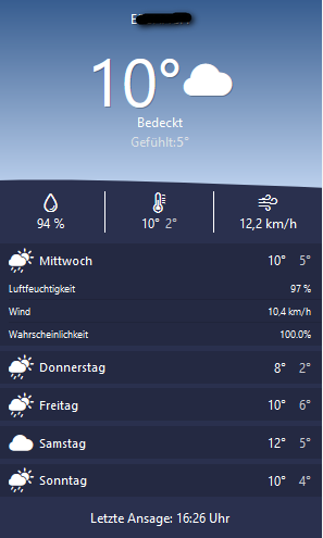

Widget-Result:
grafik
As you see all looks amazing include the correct location, but still the same boring warnings:
2021-02-02 17:03:03.642 [WARN ] [e.internal.SseItemStatesEventBuilder] - Attempting to send a state update of an item which doesn't exist: ForecastTomorrow_Iconid
2021-02-02 17:03:03.654 [WARN ] [e.internal.SseItemStatesEventBuilder] - Attempting to send a state update of an item which doesn't exist: OneCallAPIweatherandforecast_ForecastDay1_Iconid
2021-02-02 17:03:03.659 [WARN ] [e.internal.SseItemStatesEventBuilder] - Attempting to send a state update of an item which doesn't exist: ForecastDay2_Iconid
2021-02-02 17:03:03.670 [WARN ] [e.internal.SseItemStatesEventBuilder] - Attempting to send a state update of an item which doesn't exist: ForecastDay3_Iconid
2021-02-02 17:03:03.680 [WARN ] [e.internal.SseItemStatesEventBuilder] - Attempting to send a state update of an item which doesn't exist: ForecastDay4_Iconid
2021-02-02 17:03:03.690 [WARN ] [e.internal.SseItemStatesEventBuilder] - Attempting to send a state update of an item which doesn't exist: ForecastDay5_Iconid
Here once again the item-scheme and the YAML-Code:
weatherPopupRG.txt (29.5 KB) oncallRG.items.txt (44.1 KB)
Is it possible that the code was changed ? I used it from here
