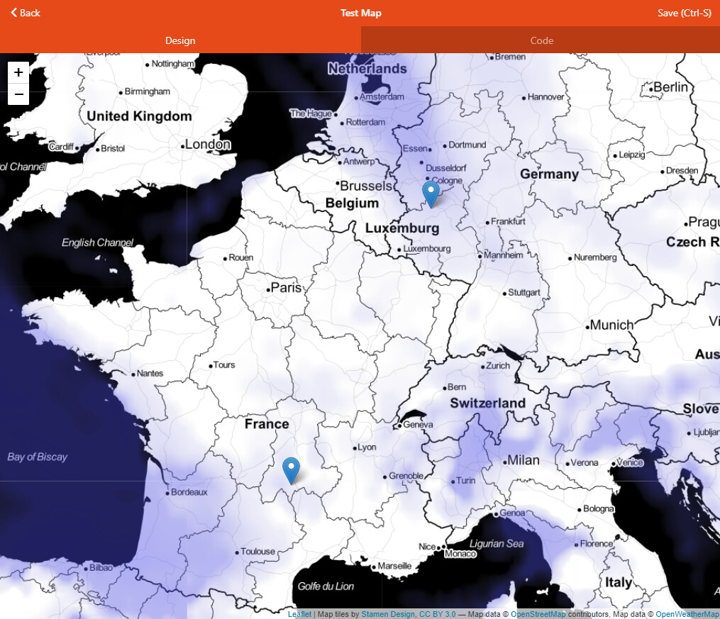

This would look lovely as a popup to a marker in a map page, since map pages can now display weather overlays from OWM :wink:
Will update my build immediately and try it out :stuck_out_tongue:
Would this work also the other way around - implementing this kind of map as an inline-view inside of widgets?
Despite that I feel like the weather-guy on the news right now after starring on all that weather-informations for hours… :crazy_face:
// Edit:
Works very well - is the API called each time the map gets opened?

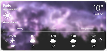

And another one with a smaller footprint inside a card…
Additionally to the above mentioned items, it uses this:
Number                  localCurrentApparentTemp            "Apparent Temperature [%.0f°]"      { channel="openweathermap:onecall:api:local:current#apparent-temperature" }
→ See the first post for a new version

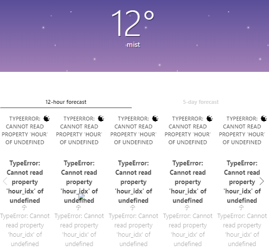

hi @RGroll, i cant seem to get it work. I imported your item definition, added a prefix in item names while importing and in the props too, but this is what i am getting in the widget. And i am on #2077. Any suggestions
When did you copied the code as I changed the syntax of oh-repeater today? I will check this after my OWM binding is working again (something broke after updating to RC1)
Just to take everything into account - what prefix you’ve added?
We’ll see… for 3.1 :wink:
got it to work. it was the loop.day vs. vars.day issue. I guess RC1 should solve it. For #2077, its still vars.day
Btw, just a note for others - for images, custom URLs for local images have to be within the /etc/openhab/html/ folder.
So:
/etc/openhab/html/weather_img/skyline_day.svg is /static/weather_img/skyline_day.svg
Thanks for your response and glad you got it working! Do you changed loop back to vars now or do you updated your version?
But somewhat strange… - I used 2077 before updating to RC1 for testing and loop worked there. Maybe it is some other problem then… I’ll have a look.
@ysc I think there might be an error with the frequency of the OWM API calls in context with the map-overlay for the rain radar. I wondered why my OWM binding can’t connect and saw this in my OWM overview :stuck_out_tongue:
How often does it refresh?
Yeah i changed it vars for now. Don’t know if RC1 is out yet … its not showing for me via sudo apt update. Maybe its in a different repo from the snapshot. Anyways, snapshots will catchup in a day i guess, will change it again :slight_smile: thanks.
Every time the map is shown, I suppose.
Hmm, I tested it but I don’t think that I’ve refrehed the map view that much… Maybe I had the browser-tab opened with my modal in the foreground and every time I saved some changes to my widget, the widget and also the map view got refrehed … but just guessing.
I will deactivate it for now and test this later with another API key :slight_smile:
Hey @candiesdoodle
tested it again with build 2077 and a prefix - everything is working as expected. So ‘loop’ seems to be implemented here. I’m wondering, why it’s working with ‘vars.’ in your setup?!
But if it does, everything is fine :slight_smile: - tell me, if you run in trouble with future versions then.

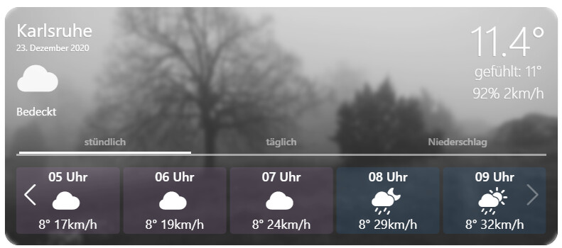

Your UI widget encourages me to tweak it a little. Many thanks @RGroll
Features:
  • more customable translations
  • windspeed and humidity
  • Items are generated by UI (Create Equipment from Thing) exeptional “localStationName”
String OneCallAPIweatherandforecast_localStationName “Name” (OneCallAPIweatherandforecast) [“Point”] {channel=“openweathermap:weather-and-forecast:OpenWeatherMap:local:station#name”}
