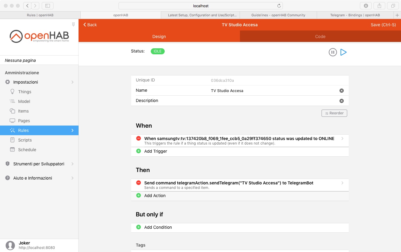

Hello there, I have been trying to set up a rule to send me a message through TelegramBot whenever a Samsung TV is turned on.
I have used the UI to generate the rule
and the code generated is this
triggers:
- id: "1"
configuration:
thingUID: samsungtv:tv:137420b8_f069_1fee_ccb5_0a29ff374650
status: ONLINE
type: core.ThingStatusUpdateTrigger
conditions: []
actions:
- inputs: {}
configuration:
itemName: TelegramBot
command: telegramAction.sendTelegram("TV Studio Accesa")
type: core.ItemCommandAction
OpenHab does correcty āreadā the status of the TV (I have been turning it on and off via its own remote while looking at the āthingsā page), however the trigger chosen (Status) seems not to activate the rule.
I am a little confused by the literature. Where am I supposed to insert the
val telegramAction = getActions("telegram","telegram:telegramBot:<uid>")
to call up the rule actions as specified in the Telegram - Bindings documentation?
The BOT has been correctly activated and tested with success following the above documentation.
Please help!
