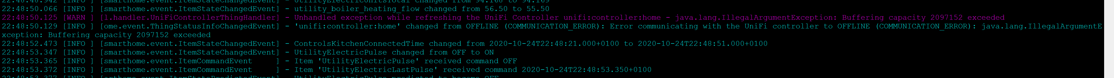

I have around 120 WiFi devices and it’s now become unusable as I get the buffer exception.
Compacting DB does not help either.
I’m using 2.5.9 with
257 x Active x 80 x 2.5.9 x openHAB Add-ons :: Bundles :: UniFi Binding
Or another work around?
