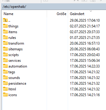

There is no folder ‘/etc/openhab/Raspberry Pi’ on the raspberry pi:
Have you looked in /var/lib/openhab for that path?
How are you editing these flles on the Windows machine?
What happens if you change the path on Windows to not include the space? Does the error change? A file not found error might give a clue where the invalid URI error does not.
