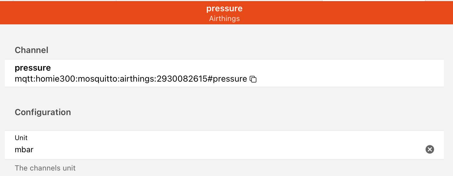

Note that with MQTT and Homie devices, you can directly configure what unit the device is sending on the channel, and it does not have to match the unit on the linked item:
If the item’s unit does not match the MQTT’s channel, it will be converted to the item’s unit as appropriate before being stored.
I’m not sure why this isn’t exposed for Generic MQTT Things. I sense a PR in my future… :wink:

It’s there under “show advanced”.
It’s been around since the 2.x days I think. I don’t remember exactly when it was added but it’s been a long time.
don’t want to hijack this thread (again), but my pure-MQTT channel in 3.3 doesn’t show units for configuration. Perhaps it’s “homie-device-only”.
I’m pretty sure I’ve been using units for longer than the last six months but could be wrong. I only use Generic MQTT Things.
ah. Guess I was blind. found it.

Note: I got a chance to set it and it does appear to work as expected when using the unit in the MQTT Channel config. I set °C as the unit and it converts it to °F on the Item which has %.0f °F for the State Description pattern. Woohoo! This is the only transformation I have in my system. :smiley: Unlike the rest of the world, I try to eliminate transformations and profiles instead of rules. :rofl:
