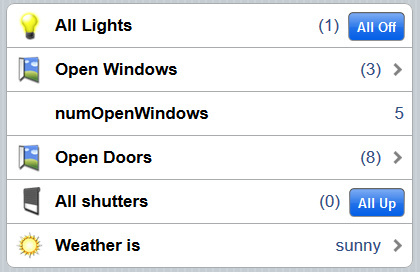

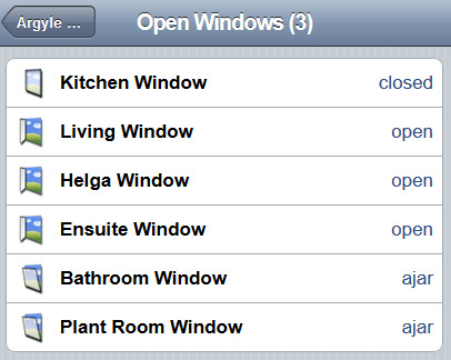

Second result
The counter for open windows now also works!
/* ***** determine number of windows either open or ajar ***** */
rule "Number of open windows"
  Item gHouse_Windows received update
  logInfo("OpenWindows1.rule", "testing, gHouse_Windows received update")
  val numOpenWindows = gHouse_Windows.members.filter[w | w.state.toString != "CLOSED"].size
  logInfo("OpenWindows2.rule", numOpenWindows.toString)
  OpenWindows.sendCommand(numOpenWindows.toString)
2016-07-31 11:50:08.362 [INFO ] [c.internal.ModelRepositoryImpl] - Refreshing model 'max01.rules'
2016-07-31 12:33:44.906 [INFO ] [model.script.OpenWindows1.rule] - testing, gHouse_Windows received update
2016-07-31 12:33:45.870 [INFO ] [model.script.OpenWindows2.rule] - 5
It shows 3 as open, but numOpenWindows shows 5 (now including the AJAR ones too).
All I have to do is clean up the UI… :slight_smile:
